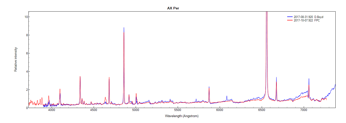

A spectrum obtained by Fran Cmapos shows the classical symbiotic AX Per in outburst
Large spectroscopic changes incomparison to recent spectra obtaines by Davis Boyd, Tony Rodda, James Foster, notably disappearence of [Fe VII] lines
(Cooling of the expended envelope)
ARAS DataBase: http://www.astrosurf.com/aras/Aras_Data ... /AXPer.htm
It is consistent with the rise of luminosity détected by David Boyd (V Band)
Further observations are strongly recommanded

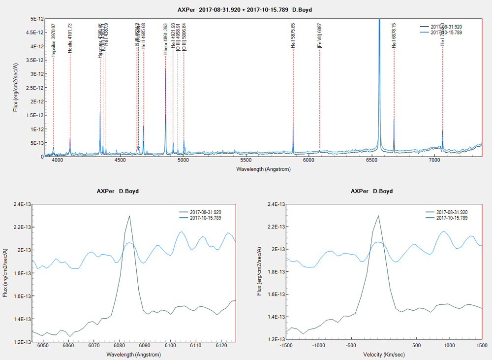

David Boyd
- Posts: 164
Re: AX Per in outburst
These spectra show the change between Aug 31 and Oct 15 corresponding to a V magnitude increase from 11.33 to 10.87. The emission line flux of the hydrogen Balmer and He I lines has doubled. However both the He II and H-beta line fluxes have increased in the same proportion so the hot star temperature as estimated from the He II/H-beta ratio is almost unchanged. Also note that the [FeVII] emission line has disappeared (lower left plot).

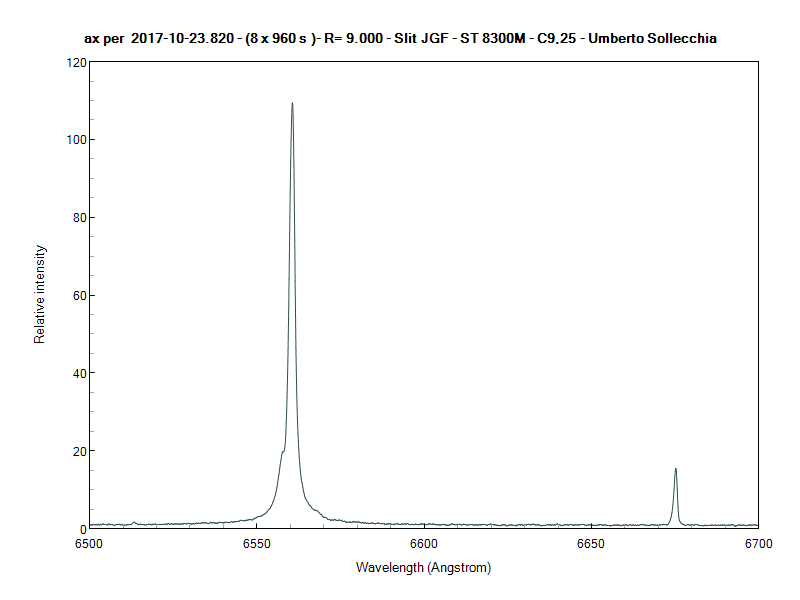

- Posts: 247
Bonsoir, le spectre d'AX FOR observé le 23-10-2017.Salut -Umberto

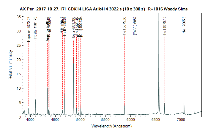

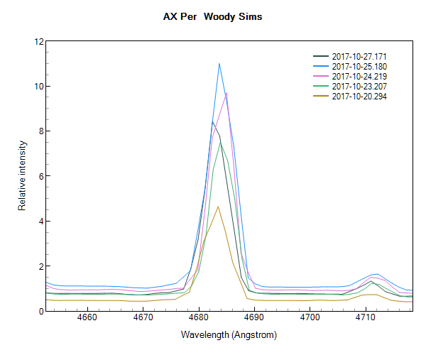

Forrest Sims
- Posts: 86
Here is my plot of AX Per from 2017-10-27.171.
I have also included the subplot centered on HeII at 4,885.68 for my last 5 observations.
cheers!
Woody
cheers!
Woody
- axper_20171027_171_Woody Sims annotated.png (31.06 KiB) Viewed 11932 times
- axper 5 nights subplot HeII.png (28.23 KiB) Viewed 11932 times
