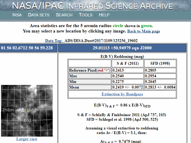

1. Is there any interstellar reddening of the target ?

Also there is some significant galactic extinction in this direction so there could be some interstellar reddening as well
