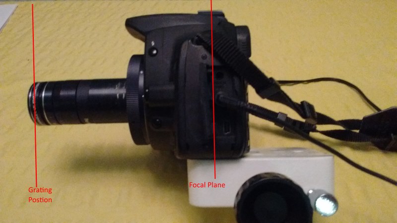

Re: star analyser
Hello Sébastien,
You can increase the distance if you want to. The SA100 moves further into the telescope but the focal plane stays at the same position. Note at F5 the maximum allowed distance from sensor to grating is 125mm and you should put the star zero order near the centre of the field to avoid vignetting.
- SA100_DSLR_eyepeice_holder.jpg (62.97 KiB) Viewed 7767 times
