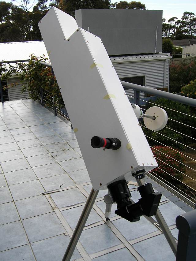

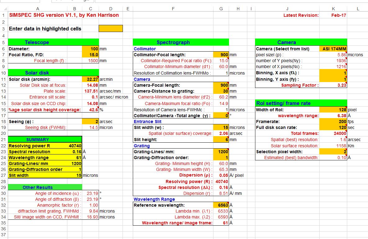

I recently built a prototype spectroheliograph using a Carton 4" objective for the telescope and a Littrow spectrograph, based on a 50mm sq. 1200 l/mm grating, a 60mm Carton lens (working at f15), nominal 15 micron slit gap and the very fast ASI 174MM camera.
It seems to achieve around R=40000
shg build 018.JPG (95.83 KiB) Viewed 8256 times
