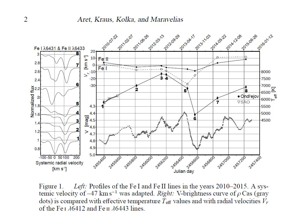

I found the following paper A New outburst of the Yellow Hypergiant Star Rho Cas available here https://arxiv.org/pdf/1611.04493.pdf
I attach its Figure 1 which shows the development of the Fe I and Fe II lines at 6431 and 6433 respectively. I also attach my recent observation which shows it continues to develop.
Figure1  From  Aret, Kraus, Kolka and Maravelias

While all spectrographs have pros and cons the wide range and medium resolution of my MRes R ~ 10000 allows the following of several sets lines - even unplanned ones!

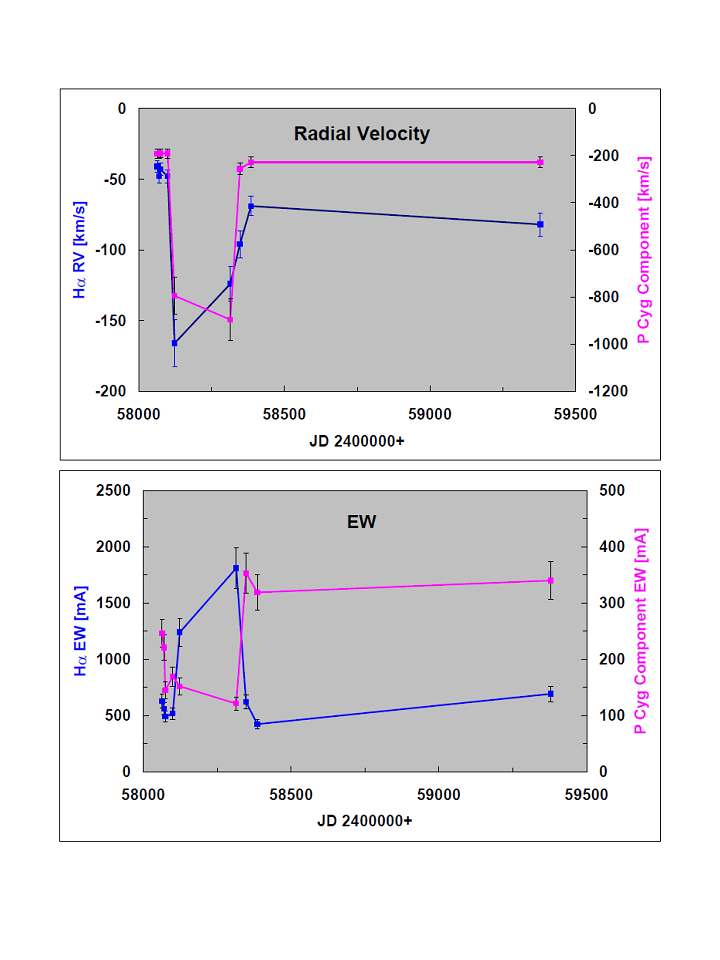

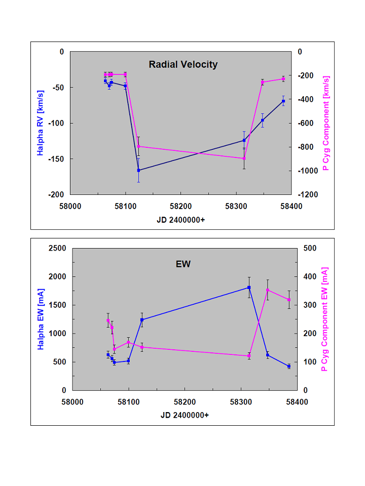

According Klochkova et al. (Astronomy Reports, 2018, vol. 62, No. 9)
Thus, the ejections in rho Cas are becoming more frequent. According: Astrophys. J, 583.923 and ASP conf. Ser. 508, 357, this may indicate that the star is approaching a crossing of the Yellow Void. This fact suggests the urgent need of further monitoring of rho Cas”
I tried by use spectra of the BAA data base (A. Smith, F. Sims, D. Boyd, J. Paraskeva) to find out something of the Hα radial velocity and the Hα equivalent width during Nov. 2017 to Sept. 2018 (see Fig. below).
The spectra have been evaluated for the Hα absorption and its blue-shifted PCyg-component.
By considering the RV and EW, it seems there has been an ejection within that time section. Both parameter of the Hα absorption seems to be confirmed to each other. Also the RV of the blue-shifted PCyg-component seems to confirm the ejection. Only its EW behavior do not fit to that event. Unfortunately there is a large gap of observations between Jan. to July 2018. If there further spectra of other observers available, it would be nice if I could receive these for further analysis.

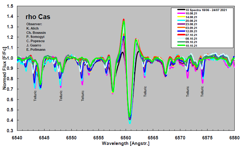

After more observation experience in the meantime, the focus of the evaluation of the monitoring has been changed.
Above all, the behavior of the red and blue emission components has now come into focus. In the course of the previous spectra, their flux has clearly increased.

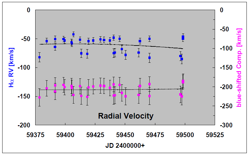

In addition, the radial velocity of the central Halpha absorption and the blue-shifted P Cygni component are further monitored. It is currently not clear whether the scatter is real or is due to inaccuracies in the wavelength calibration. This will continue to be monitored.
