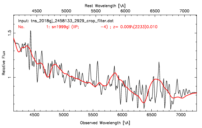

Re: bright supernova alert NGC6217 - spectrum needed
Thanks Etienne,
SNID predicts a type IIP but with reduced confidence (rlap =3.7 compared with 5.0 for a reliable classification ) see attached SNID best fit

- Posts: 1041
Thanks Robin for the alerte.
It's a very lucky time for the weather.
For the type of SN it's possible that is a type IIP. I think it's interesting to take a new spectra in many days or 1 week. If the weather 'll good i take spectra of 1800s for a better SNR.
Hi Etienne,
Yes early type II are difficult. The spectrum should develop stronger Balmer lines later.
