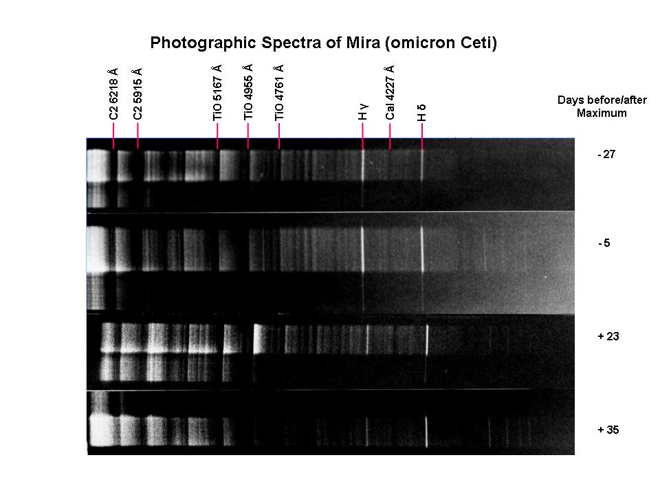

here are the photographic spectra of my friend and colleague Bernd Hanisch (Germany, Frankfurt/Oder, near polish Border.)
The spectra were taken with a small Newton telescope 120/690 mm combined with a 45° prism in front of the telescope, on "ORWO NP27" (film material of a company in Eastern-Germany) between 1989 to 1991. The size of the prism did cover the total aperture of the telescope.
The spectra series have been take depending on the phase after the maximum in visual brightness.
omicron Ceti.jpg (62.02 KiB) Viewed 10351 times
Ernst

Nice C2 and Ti absorptions! Are the duplicate spectra underneath the 4 dates 2nd order? Looks like the TI absorption strength change before and after maximum.
Posts: 1565
Re: Mira in near UV---Outburst?
A nice piece of history, Ernst!
Note that C2 can't exist in Mira, which a M star, with only TiO bands (VO also in the near IR)
C bands appears in Carbon stars due to the lack of oxygen
Yes, James, the spectral type for Mira varies from M5 to M9 (maximum to minimum luminosity)

... no James, not the second order.
The used prism was made from a very special (rare) sort of material (in german: Bor-Kron-Glas), which provided spectra of the first order until the near UV-area on the used sort of emulsion.
Ernst
