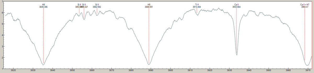

After several experiments (initially targeted H-gamma + CaI 4227- where have had flat problems), returned to the CaII H/K region where already have some practice:
This one is 18 x 5 minute (23 micron slit, 2400/mm grating, R~6000 average, speculated of a serie - a 5 x 5 min could be already enough), and the total sum got absolutely noiseless. Also returned to this object multiple times within a total of 5 hours interval (clouds in between) trying to catch any variability, but finally couldn't detect anything above noise (was expecting at least some RV change from the 1.5 day period).
On the graph, I've taken features from "1976, THE RADIO-FLARING TRIPLE SYSTEM b PERSEI (Graham Hill, G. C. L. Aikman, and Anne P. Cowley)".
Conclusion from this graph:
- Balmer has a wide V-shape (+/- 1500 km/s velocities at edge points)
- Ca II 3933 having 150km/s at half width, and the small features (Si II, Ti II, ...) look to be similar
In case anyone takes this region again at a similar resolution, I'd happily look at the differences (no professional hint yet).

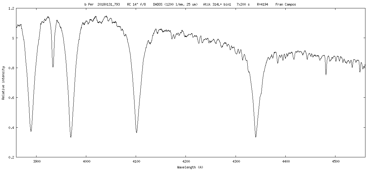

Hi, Peter,
thank you for the comments. I took last night a spectrum but my resolution is worse (bad focusing I believe). I see important differences. Look for example at Ti II band (3913 A). In your spectrum is clearly visible but not in the mine.
I'm going to sent this spectrum to the AAVSO. I asked for more information about what they expect from these spectra but I still haven't received reply.

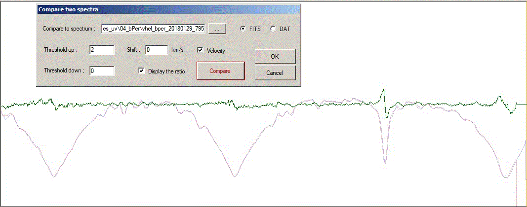

Yesterday I've taken a 2nd spectrum (13 x 5 min), and apart form a 5% continuum error (equalised via a low order curve fit division just for an easy comparison), I get only small radial velocity difference now - per components:
Compare _bper_20180204_764 to _bper_20180129_795.
Manually testing rv shifts (step: 1 km/s), I'm getting these values per feature (2018.01.29 vs 02.04 yesterday):
H8: -9 km/s (+/- 1 km/s)
H9: -10 km/s (+/- 2 km/s)
CaII 3933: -14 km/s (+/- 0.5 km/s on center)
Ti II 3913: -20 km/s (+/- 5 km/s, noise)
Si II 3856: -15 km/s (+/- 3 km/s)
As for the weak features shifts, for practical reasons I've subtracted a close value to 1 (here chosen 0.7) from both spectra to enlarge the ratio errors.
The rv shift differences after this 1 week period between Balmer (9-10 km/s) and metallic lines (14-20 km/s) is doubtless via testing the shifts via human look.
Hope any of us may catch bigger changes in the next week (not much time left)!
- Peter

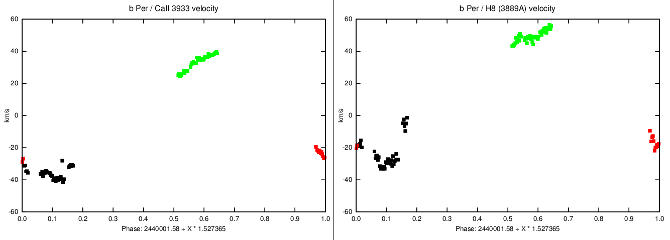

Hello James,
Such an RV shift is well expected in b Per in short term.
As an example, here I attach my period-RV diagram of my CaII 3933 and H8 features:
black: evening of 2017.01.29, 37 x 5 min (clouds in between, but like 6 hours coverage, its end was suffering of athmospheric effects)
red: evening of 2017.02.04, 13 x 5 min (only 1 hour, but the most shift... also perfectly extending the previous serie)
green: evening of 2017.02.11, 46 x 5 min (~ 5 hour by coverage)
(using scripted lamp between each exposures, calibrating the frames individually)
To get the centroid, I've used here a scripted way (IRAF: splot/d feature) to measure the centroid, and still experimenting... For CaII, the profile very much obeys Lorenzian or Voigt type (but definitely not Gauss). For the Balmer V-shape, none of these profiles obey... might be also composite, and unsure why seeing shift (but such a shift between metallic and Balmer also mentioned in the document form 1976)!
The graph itself is helocentric (applied a constant value per session - adds 0.2km/s error, it's my neglection) and average vrad-corrected (by the 19.7km/s value from Simbad).
But as you can already see, the CaII diagram obeys SB9 database's diagram - see:
http://sb9.astro.ulb.ac.be
(direct link should be: http://sb9.astro.ulb.ac.be/Orbits4onesystem.cgi?226 , please scroll down to the graph...)
The CaII is a very dominant and nicely obeying feature, free from A component's contamination, and the 3rd F compaion is weak (should be at 0 km/s as of now, but yet I can't elaborate).
So far, everything is known... (the 80 km/s difference is visually the whole width of CaII 3933 on my raw frames)
Nevertheless, it's my first EB system, and happy to learn it.
I am amateur-personally very interested in your CaII/H8 spectra missing from my serie, preferably in a form of a serie of sub-exposures - you must haven been much luckier than me by catching the critical time! In case you send me, I would be happy to investigate (again, as a non-professional)!
Also suggest that you shoot it again out of the eclipse, maybe it can't perfectly compare with mine (changes must be weak).
By the way, to show up something for the profs, what we finally need is one of these:
- find a signature of the faint 3rd component (I'm still investigating, perhaps need to artifically reconstruct all the components, RV-shifted for each exposure ...)
- any visible spectral change due to eclipse (your spectra is critical here, mine didn't show anything obvious - other than the well expected shifts...)
