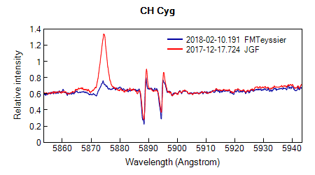

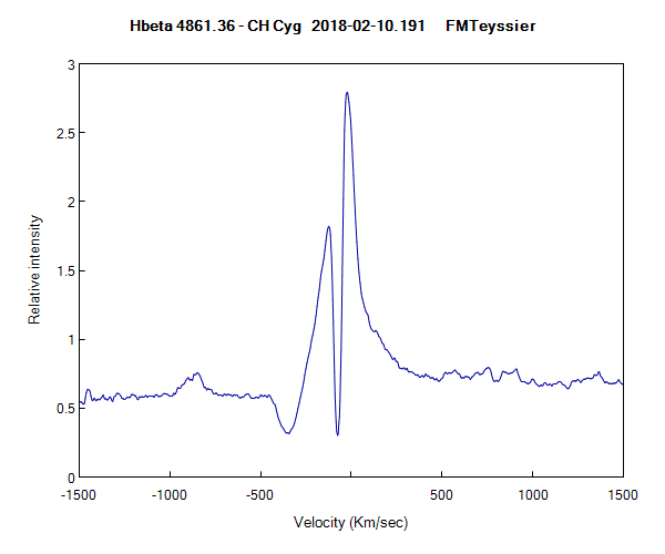

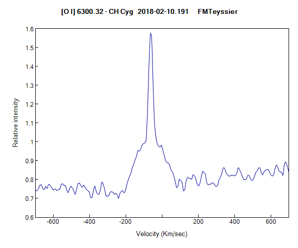

New season and still surprizing ...
H beta:
Very deep central narrow absorption (under the continuum)
and a broad and deep absorption at -350 km/s (max velocity = -500 km/s)
Helium lines (He I) have vanished
(comparison with the last spectrum in the database, obtained by Joan)
I recall that several professionnal teams are working on our spectra.
Coverage at the best cadency as possible is requested.

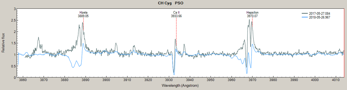

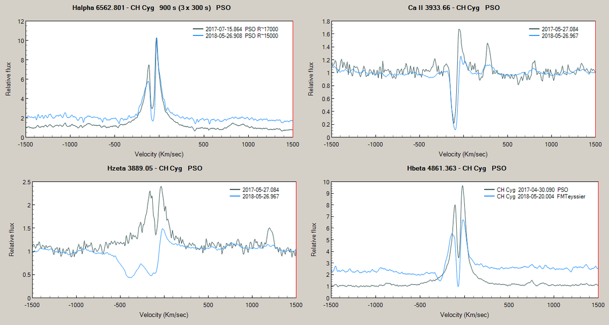

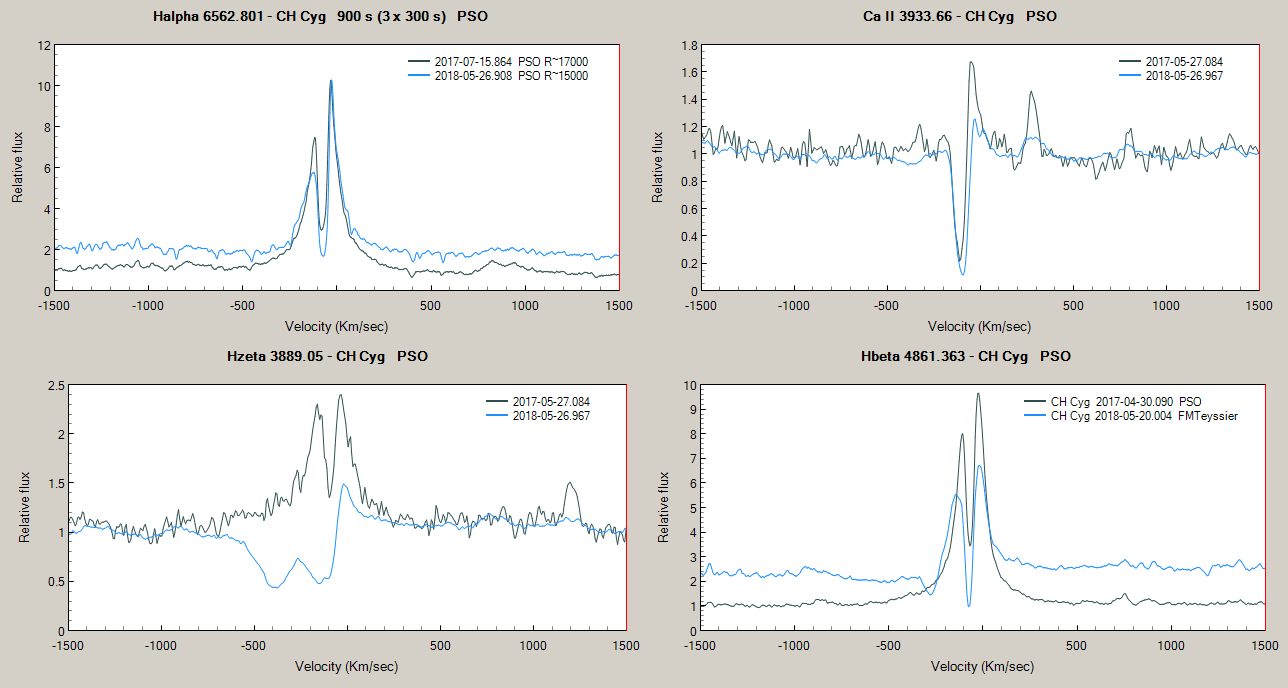

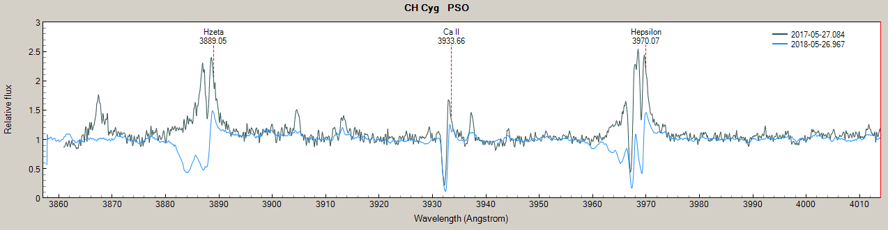

Let me report here an experiment I've made.
Last year I've shot 2 x 10 minute exposures for the CaII region (unsent due to low snr and faint blue), that I've repeated yesterday (6 x 10 min, lately found too easy), R~5200 in both cases (35 micron slit, ATIK 428 EXm).
Now using the last year's experiment as a baseline, the emission velocities of that time look as if they were negated:
last year vs yesterday
To compare velocities of more Balmer in overall (borrowing a recent H-beta from Francois):
compare various Balmer and CaII velocities
I will be curious whether we see this -500 km/sec at H-zeta in the database soon (in 2015 we saw -1500 km/s, last year was mostly silent). At least, the lower Balmer lines are now a matter of suspect consisting of both absorptions + emissions.
For now this was just an experiment, documenting the result.

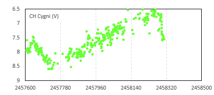

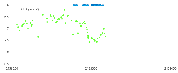

CH Cyg is rapidely fading (see:http://spectro-aras.com/forum/viewtopic.php?f=12&t=2055)
(V = 6.6 to 7.5 in a few days)

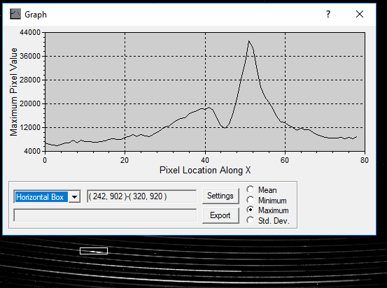

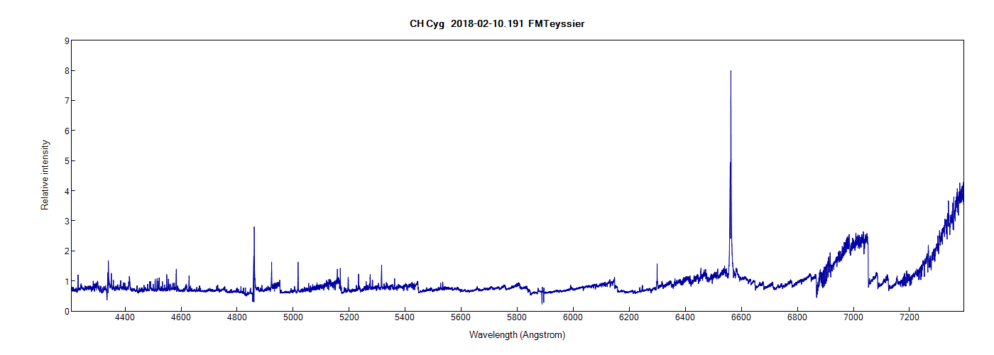

My last spectrum of CH Cyg taken with eShel II
Order #34 (H Alpha)
[OIII] range
And Balmer Lines

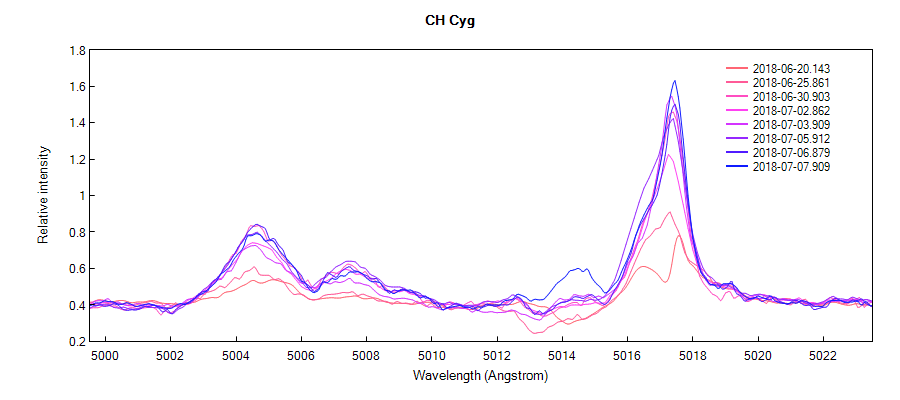

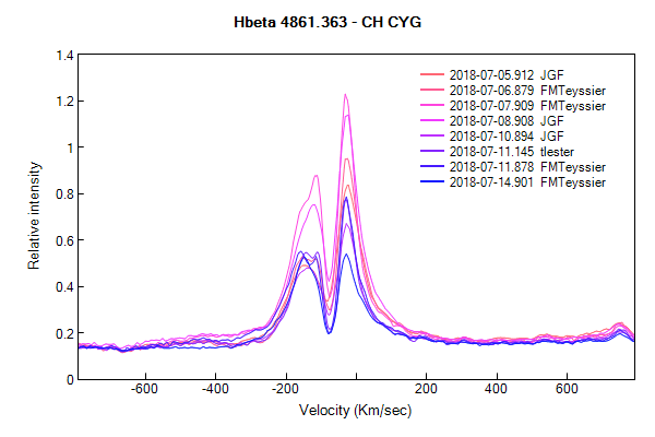

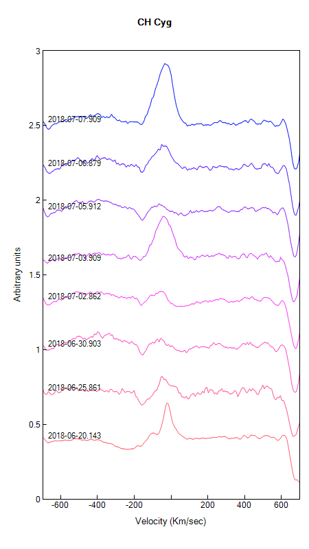

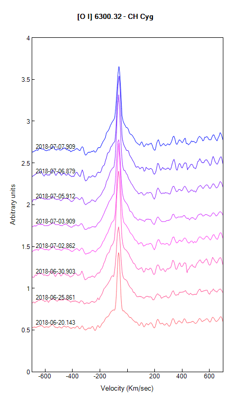

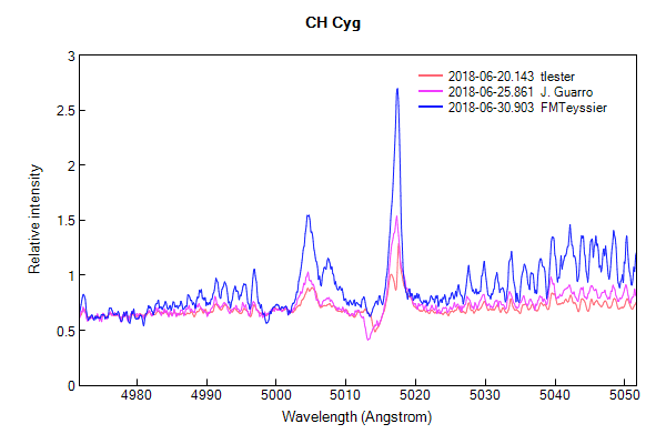

An update during the decline
It looks that the luminosity is stable (with flickering) at about V = 7.5 since the begining of July

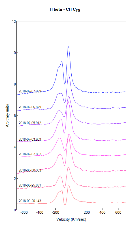

Evolution a few lines from Echelle spectra obtained by Tim Lester, Joan Guarro and François Teyssier
H Beta
[OIII] range: incresing [OIII], He I which was in absorption, now in emission
He I, complex behavior
As usual, [OI] almost stable (unless its intensity)
Of course, we continue the monitoring of the event

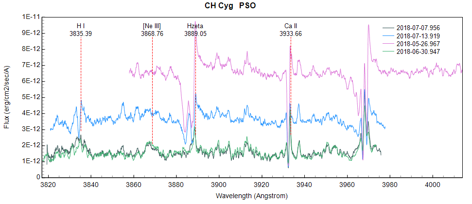

I've been using the wide slit (2-star method) with HD 191026 for my last 2 observations.
Here is the way I've been extracting absolute flux:
2018-05-26.929: used asdb_20180521_056 (JMO) + aavso around 05-26 (a bit speculative due to the 5 days shift)
2018-06-30.883: used asdb_chcyg_20180630_958 (VMA) + aavso
2018-07-07.865: wide slit + HD 191026 (notice the accidental match with 2018-06-30.883 !!)
2018-07-13.867: wide slit + HD 191026
As I notice, the M-ish features / the tiny emissions (when subtracting M7III they look so) flux remained constant.
Happy observing!

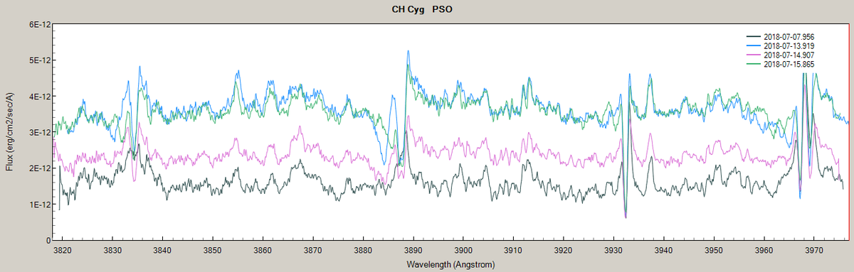

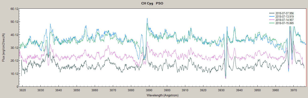

Got the possibility to shoot CH Cyg over the whole weekend (all absolute flux), presenting now the outcome:
I did check several times the flux level of 07.14 (really lower than 07.13 and 07.15), but all the 3 wide slit fluxes show very similar result.
The same continuum level on 07.13 and 07.15 is surprising (whilst 07.14 is really an exception).
Additionally, the H8 profile has changed considerably within 1 day (confirms H9 and maybe H7), compared to a so far very much constant double-peaked absorptions shape observed since 2018.05.26.
I will be curious what has changed in the visual.
- Peter
Re: CH Cyg 2018
Thta's great, Peter

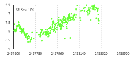

As usual, almost nothing :)
H beta
The luminosity looked to recover until July, 15th, but declined afterwards
Excellent coverage of the event.
To continue!
