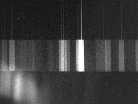

Re: etalonnage raies H & K
Hello Etienne,
Here is one of my calibration frame (ATIK 428 EXm, -15C, bin2x2, 35 micron photometric slit, 15 sec exposure):
I take 2 of this, before/after an exposure (typical real targets are multiple minutes).
Forgot to mention, with the original (non-photometric) slit, I have a poor reflection destroying my uv-flats in the middle. Hence I always prefer the photometric slit (fortune to have here), that somehow better.
Your possible problem is, that you have the Neon bulb (yellowish light), whilst the Ar/Ne bulb is purplish. Also the material of diffuser may be important, paper might be cutting here (plastics usually work better in the UV).
