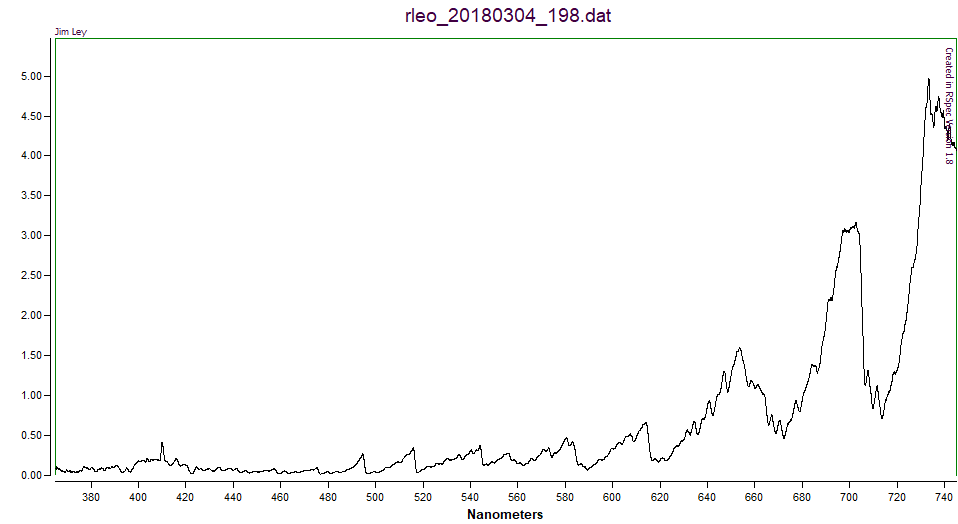

First up is R Leonis (for all but the first spectra I used Eta Leo as the reference)
Mira, period 309.95 days.

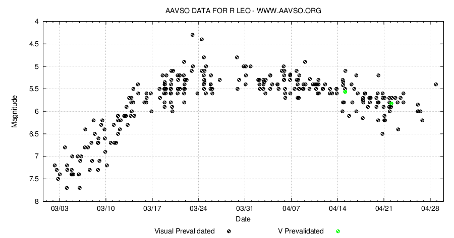

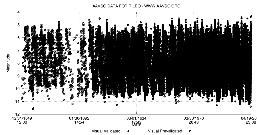

It looks like my observation coincided with a relatively brighter maximum Here is recent AAVSO data

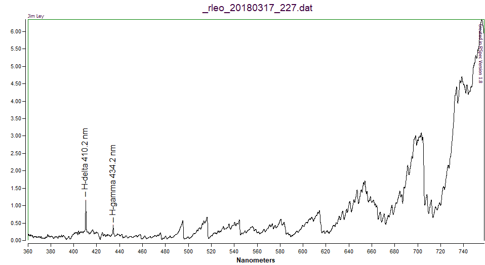

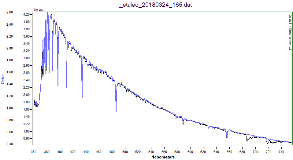

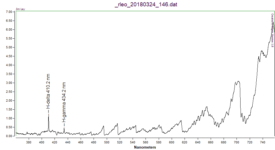

A week later 03/24/2018
Eta Leo reference and R Leo

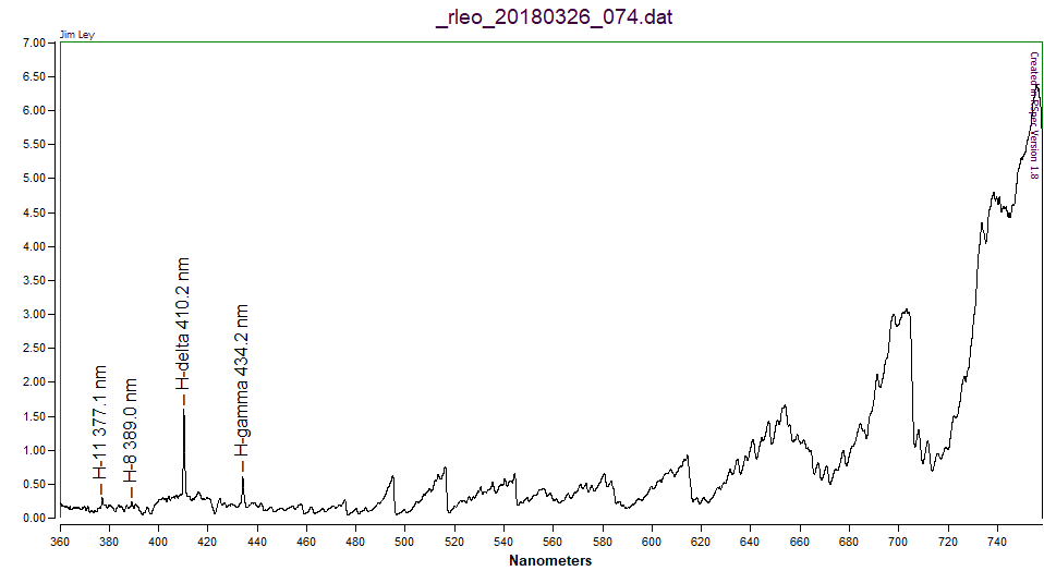

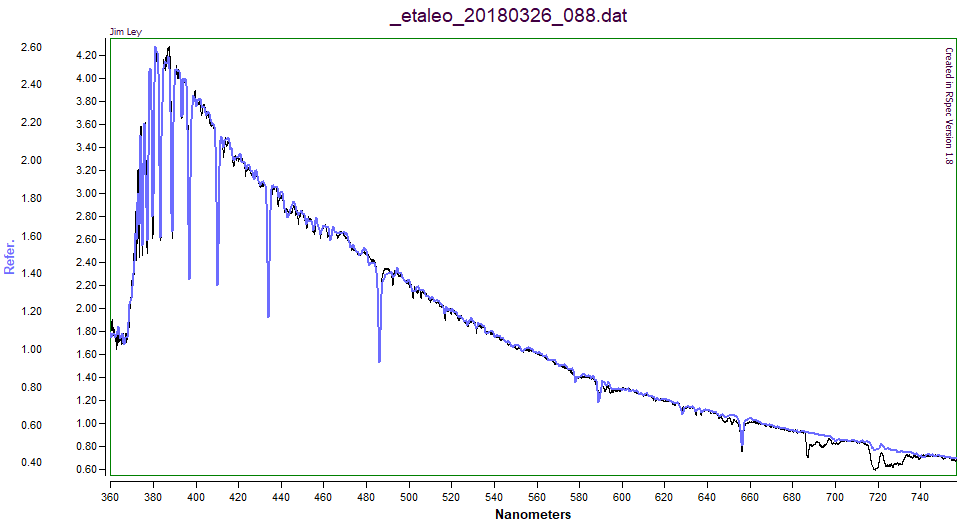

on 03/26/2018

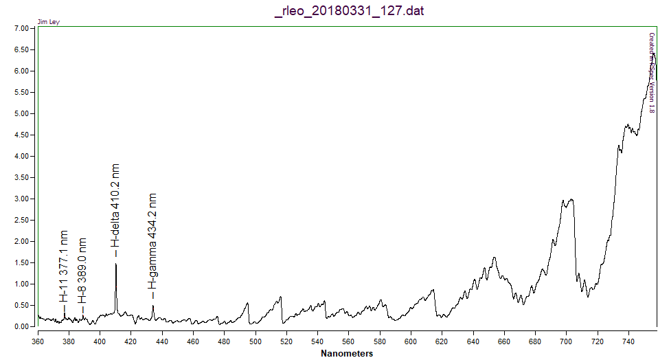

On 03/31/2018
Eta Leo reference R Leo

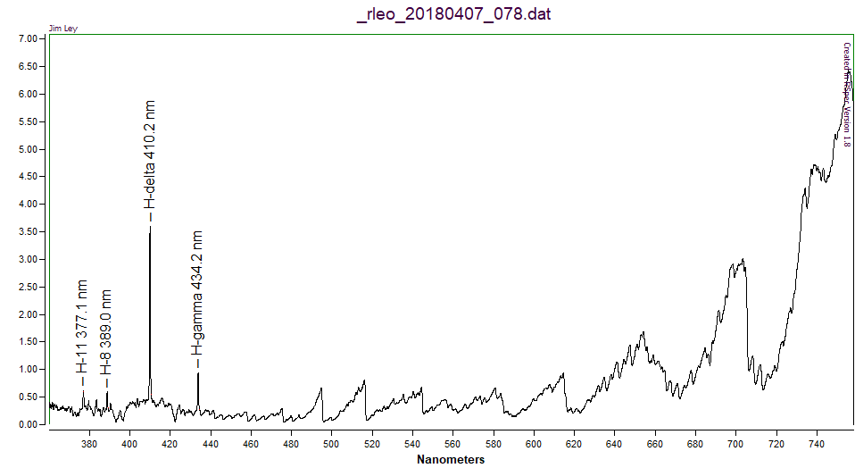

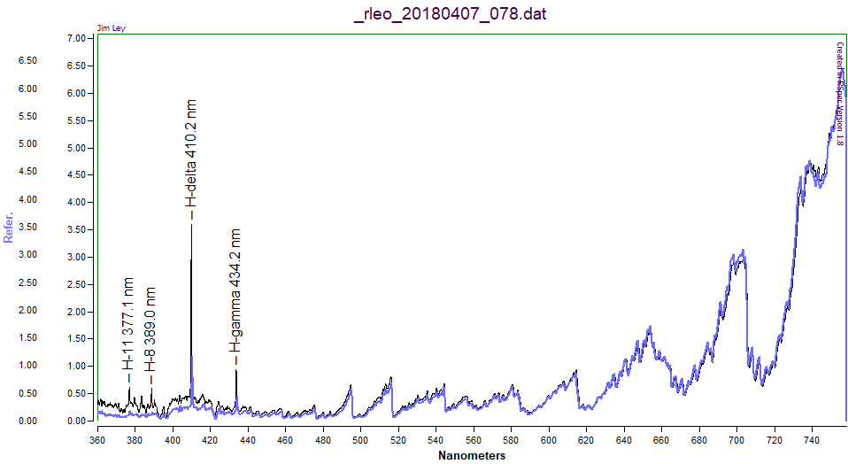

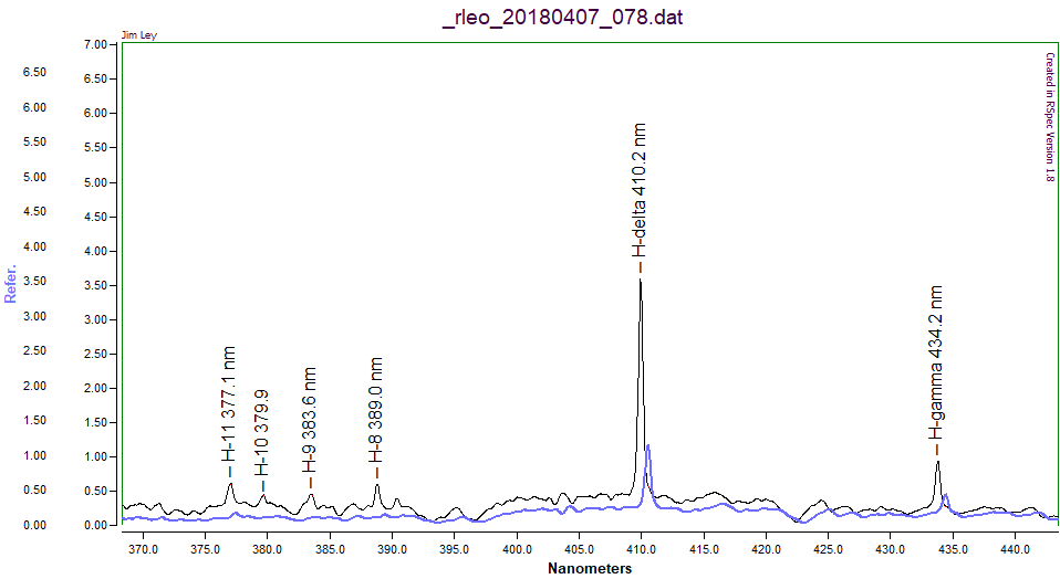

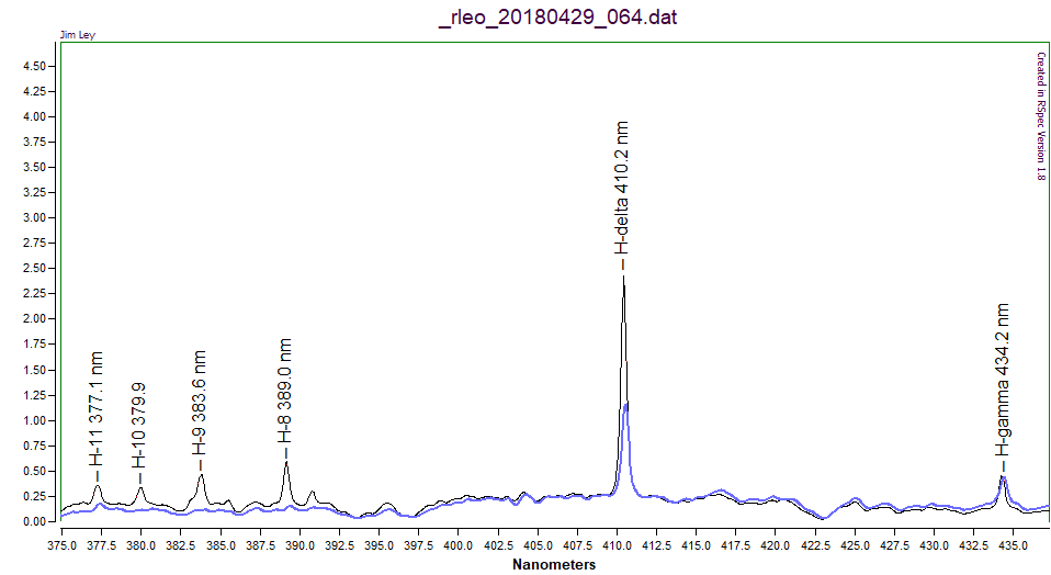

04/07/2018 was a little after maximum, when Balmer emission is likely at maximum, but the results were a little surprising, so any opinions are welcome.

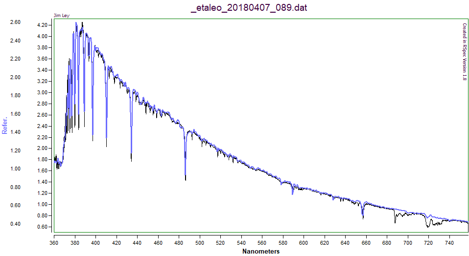

Here is the reference, Eta Leo, 20 images of 12 s, the same as all the others It looks very similar to me. In ISIS the rms for the calibration was often between 0.15 and 0.2.
Here is R Leo Not only have the Balmer intensities increased and higher order Balmer lines are visible, the blue continuum seems to have increase.
Here is an overlay with the spectrum of 03/17/2018 and here is a zoom on the Balmer emissions Notice also the blue shift in the Balmer emissions on 04/07/2018 (black) compared to 03/17/20 (blue).
I could rationalize this as the earlier redshifted Balmer emission as being material falling back towards the star, away from us, that is ionized by the precursor (ahead of the shock front). When the shock passes, the material is then moving towards us and is blueshifted. Does that explanation sound reasonable? Is it possible that I can see that with the Alpy 600?
Is the enhanced blue continuum real or an artifact?
Thanks for any opinions.

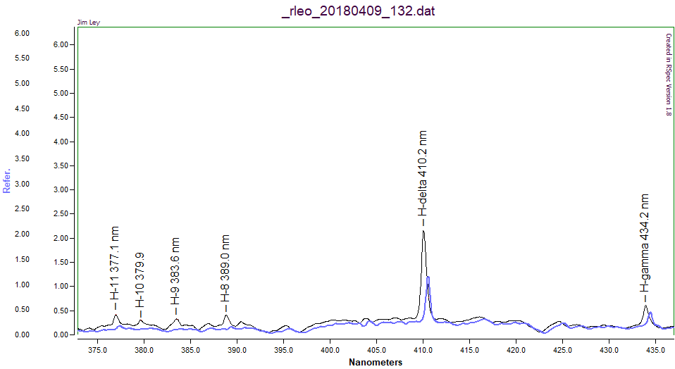

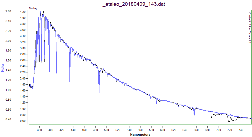

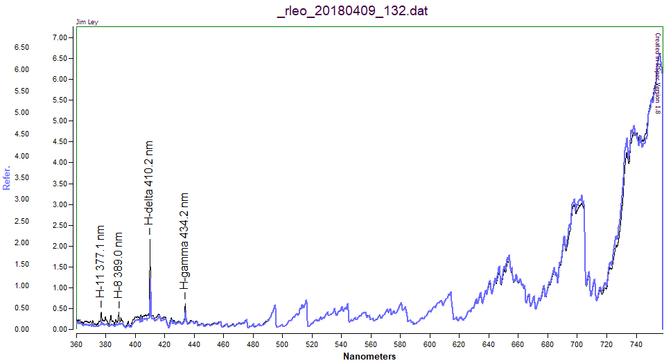

Two days later...
Eta Leo reference and R Leo The increase in the UV part of the continuum seems much less.
- R Leo 04092018 overlay.png (18.73 KiB) Viewed 13391 times

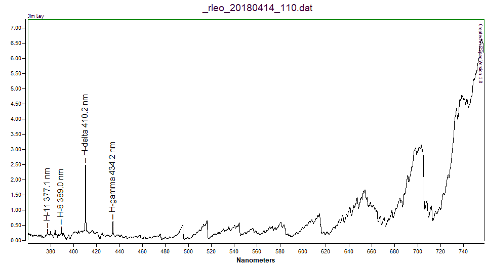

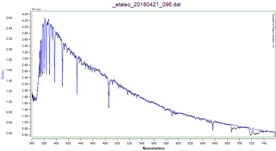

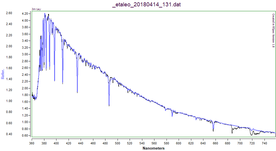

Eta Leo R Leo A week after this.
Eta Leo and R Leo
Eta Leo and R Leo

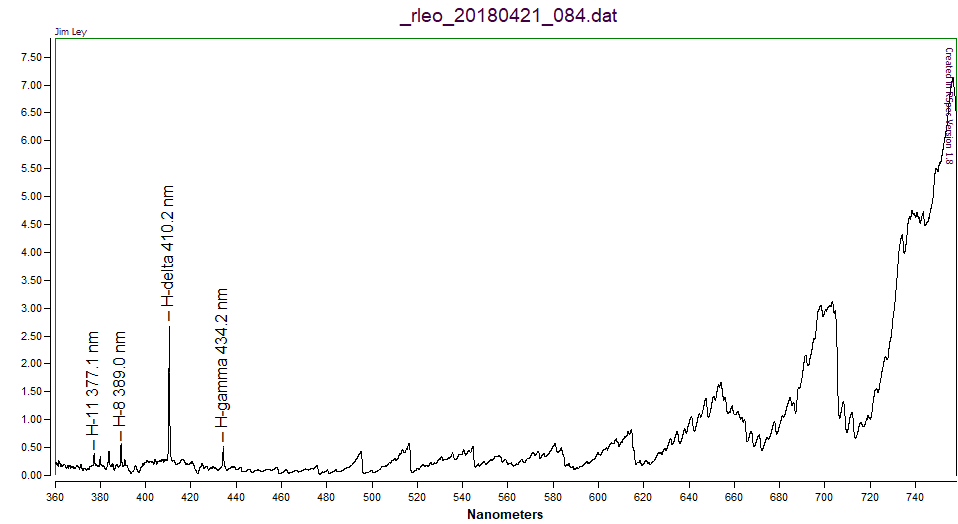

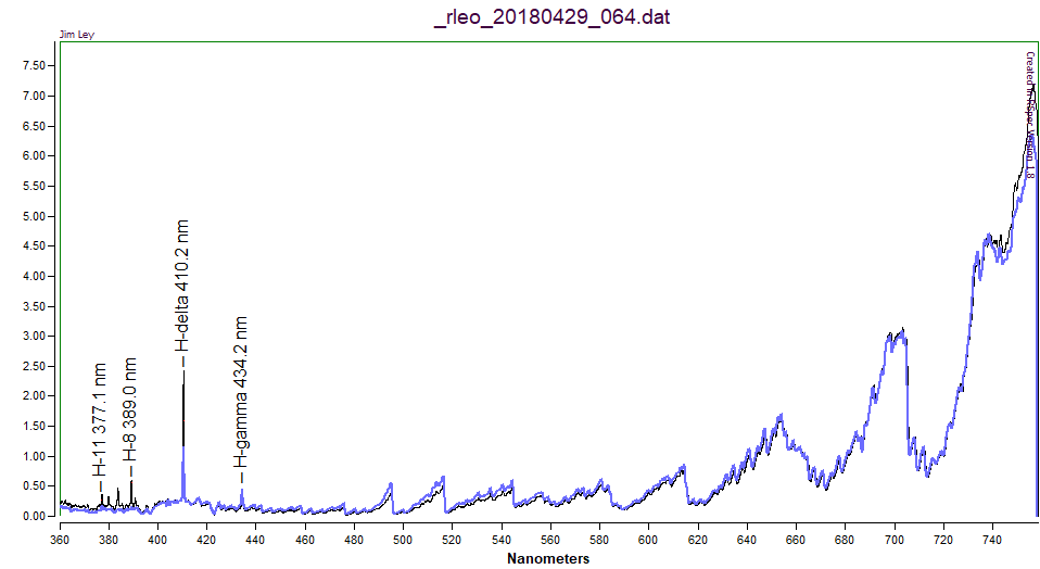

And finally, last night under a bright moon.
Eta Leo and R Leo, slowly dimishing

Great!
It will be interesting to see the graph EW = f(JD)
