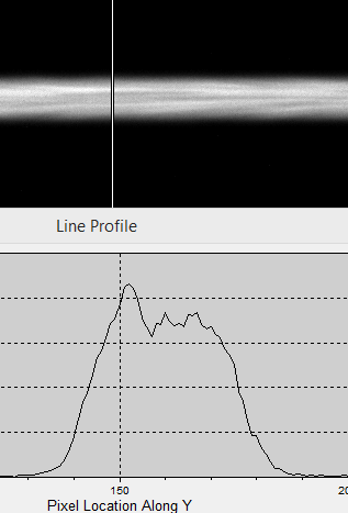

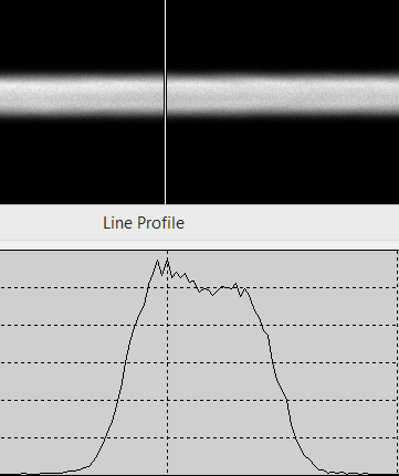

Here are some results with my Hi Res Spectrograph R ~2300 using tungsten flats. These images have a strong contrast stretch to highlight the difference.
I will be putting the new agitator into production.
No agitation
No agitation
New agitator_off.png (15.08 KiB) Viewed 4529 times
Agitation
Agitation
New agitator_on.png (15.97 KiB) Viewed 4529 times
Regards Andrew
