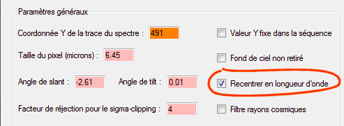

I select also the 'slant' on the same calibrationline as selected as referencepoint in the spectrum of the Ne-lamp for ISIS, in my case the 6506.528 Ang. line.

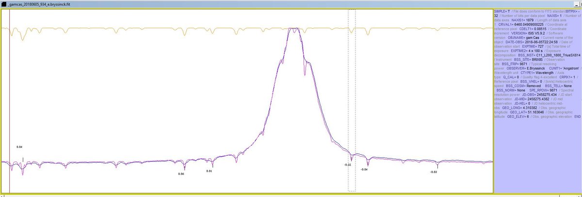

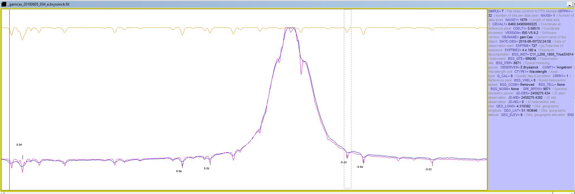

Then i check my calibrated spectrum of the star on the H2O-lines as provided in ISIS.
What I notice now is that I can not let the H2O lines coincide with my spectrum over the entire spectrum. In one way or another, there is a shift that is not linear. (see screenshot of VSpec - check the error on the left side is positiv, on the right end negativ). The first thing that comes to mind is that the calibration is wrong, so next step:

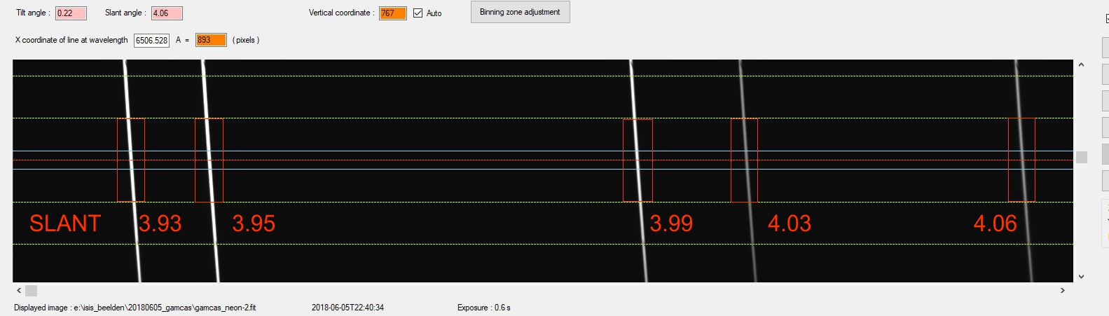

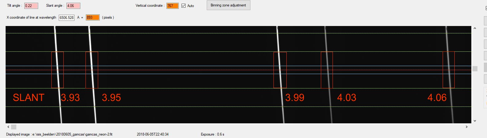

Upon closer inspection of my calibration spectrum, I notice that the slant is different for each Ne-line (see screenshot in appendix). I can obtain a further slant here when choosing a Ne-line that nevertheless has an influence on the final result.
I thought it was a problem with the L200, but when I download the ISIS turorial file and see the calibration spectrum there, I also notice a similar variation in the slant for each calibration line.

slant difference in Ne-calibration spektrum
VSPEC - H2Olines in calibrated spectrum

The change in slant along the spectrum does mean the dispersion is slightly different depending on the Y position where you measure it but this should not affect the calibration as the dispersion is calculated at the Y position of the spectrum. I do not believe it a problem of offset between the individual exposures that Michel has mentioned either as I think that would give a constant error, not a varying error along the spectrum. Which lines are you using to calculate the dispersion? Extrapolating the dispersion equation outside the limits of these lines cannot be relied on. Could this be the source of the problem ?
