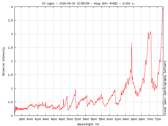

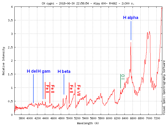

Toujours intéressé par les symbiotiques et en particulier par CH cygni, j'essaye de faire une identification des raies d'après la liste de François Tessier dans son excellent document "spectroscopie basse résolution".
J'ai quelques difficultés:
- Dans le profil ci-joint, j'observe un décalage de toutes les raies de 5 A environ. Est-ce normal ?
- Y a -t-il un logiciel commode pour construire les beaux graphiques avec identification de raies que je vois dans beaucoup de messages ?
Merci de vos commentaires
Vincent
Always interested in symbiotics and in particular CH cygni, I try to make an identification of the lines according to the list of François Tessier in his excellent document "spectroscopy low resolution".
I have some difficulties:
- In the attached profile, I observe a shift of all lines by 5 A approximately. Is this normal?
- Is there a convenient software to build the beautiful graphics with line identification that I see in a lot of messages?
Thanks for your comments
Vincent

Hello Vincent,
Your result is very nice and important for me, as it gives the ability to extract fluxes from aavso, and was a unique occasion to check ourselves that the UV continuum slope is really matching. Besides this, it allows experimenting what are the components flux ratio (here mostly M7III).
In the case of CH Cyg, 5A skew - for example at H-alpha - can be accountable for resolution merging the M-ish features and tellurics, eventually not enough pixels to represent the peak (more precise to look inside ISIS/Edit tab for the actual pixel values - rather than relying on the graphical view).
You also show R~662, which I get only with the 18 micron slit. For the default 23 micron, I've always had R~510 and seen for others. Maybe worth checking the calib.
For a good UV calibration, that's tricky - you either use ISIS feature using Balmer end, or chose calibration lines and order in a lucky way that the extrapolated polynom works the best.
These lines are bulb-dependent, I get very good calib on both ends, using calubration file method, which has this content:

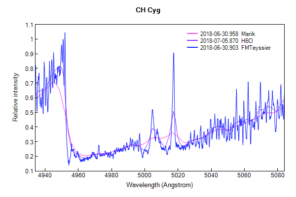

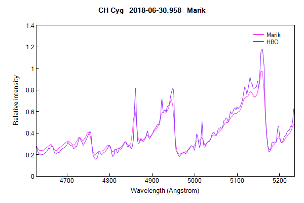

Le spectre de Vincent (R = 500) , décalé de + 5 A, celui obtenu par Hubert Boussier avec un LISA (R = 1000), un spectre Echelle (R = 11000)
J'ai choisi la région [OIII] 5007, Fe II 5018
On voit immédiatement les limites de l'Alpy. La raie Fe II 5018 ne diffère guère des fluctuations du continuum créées par l'intégrations des bandes moléculaires - principalement TiO. En revanche, elle apparaît clairement dans le spectre de Hubert, bien séparée de [OIII]
C'est la raison pour laquelle lorsque l'on me pose la question Alpy ou LISA, je réponds LISA.
Alpy est un bon outil d'apprentissage de la spectro, il fournit d'excellents résultats sur les objets faibles à raies larges (cf. Travaux de Robin, Etienne ... par exemple sur les SN), mais il montre rapidement ses limites, par exemple sur les symbiotiques.
Pour autant, il fournit des informations intéressantes :
1. Si la réponse atmosphérique est correctement calculée, il peut donner une information très importante sur le continuum
2. Il permet également des produire des résultats valables sur les raies intenses et bien séparées. Par exemple diagnostique température basé sur le ration HeII/H béta (voir par exemple les spectres obtenus sur AG Dra)
Quelle que soit la chaîne de mesure, il importe d'en connaître les limites et ne pas surinterpréter.
Par exemple, sur le spectre LISA de Hubert, le multiplet Fe II (42) - voir ci-dessous - apparaît clairement:

Commencer par identifier les raies de Balmer HI, puis la ou les raies He II (4686 la plus intense), puis les raies He I (notamment 5876, 6676, 7065)
Rem dans CH Cyg, pas de raies de l'hélium
Passer ensuite à Fe II. Le spectre du fer est très complexe. Un point : les raies apparaissent sous la forme de multiplets entre deux niveaux électroniques. Si l'on identifie 4924 du multiplet 42, on *doit* également trouver les raies 5018 et 5169 du même multiplet à des intensités du même ordre de grandeur.
En ce qui concerne les raies "interdites", on retrouve la même logique. Par exemple [OI] apparaît toujours sous la forme d'un doublet 6300, 6363 avec 6363 environ 1/3 de 6300.
En plus haute résolution, il importante également de comparer les profils. [OIII] 5007 Sse forme dans la même région que [OIII] 4959. Cela peut aider par exemple pour les novae où une autre raie se forme avant [OIII] 5007 à une longueur d'onde légèrement plus petite.
Pour en revenir à ton identification : [Fe VII] ne peut exister dans CH Cyg, au moins à son stade actuel d'évolution, car le composant chaud est supposé être un disque d'accréation d'une température ~ 50000 K
Suffisamment chaud pour ioniser l'oxygène deux fois (ce qui permet de donner [OIII], mais suffisement pour ioniser le fer 6 fois, [Fe VII])

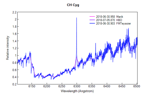

[OI] 6300 : oui et il apparaît clairement sur ton spectre Bonne continuation,

Merci Peter et François pour ces remarques qui m'aident à progresser.
En effet, je suis allé trop vite dans l'interprétation des données donc:
- pas de Fe VII dans CH Cygni
- attention à ne pas "coller" des éléments sur ce qui semblent être des raies d'absorption ou d'émission (la physique des symbiotiques est beaucoup trop riche et complexe). Donc on enlève les Fe II de l'interprétation.
-pour les raies H de Balmer cependant cela semble bon.
- Merci à François d'avoir confirmé la raie OI.
- Les spectres de CH Cygni acquis avec Alpy sont intéressants pour le suivi du continuum, particulièrement dans les basses longueurs d'onde. Je poursuis donc le suivi de cette symbiotique.
