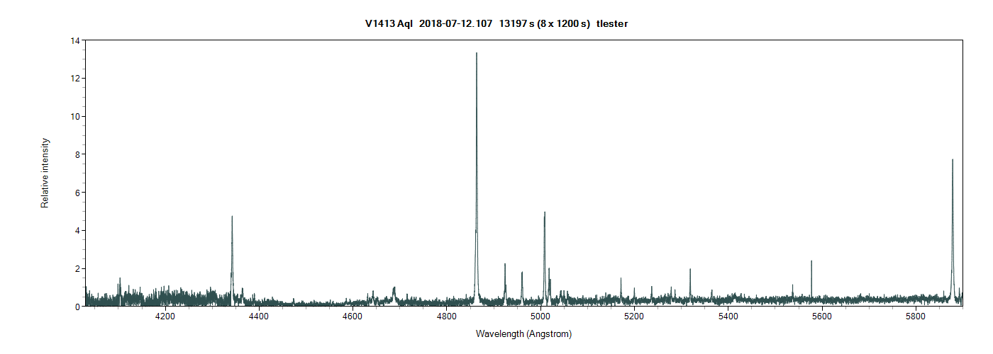

Here is my try at V1413 Aql with echelle spectroscopy. Difficult as the current V Mag is approx. 12.5 to 13 according to AAVSO.
Posts: 1557
Re: Symbiotic Nova V1413 Aql high state
A difficult target at that luminosity. Good result!

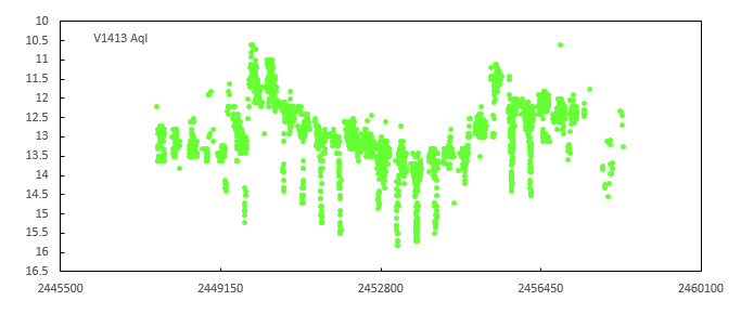

The long term AAVSO lightcurve, with 1995 and 2015 outbursts

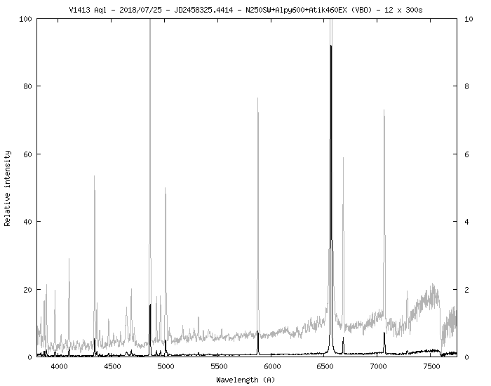

A spectrum of V1413 Aql last night at low resolution (Alpy600 + Newton 250 F/4 + Atik 460EX, 12 x 300s,R = 606)
Start of exposure at 22h TU (H = +61 deg.)
End of exposure at 23h TU (H = +62 deg.)
Reference star : HD182919 (A0V) at H = +63 deg.
Vincent
