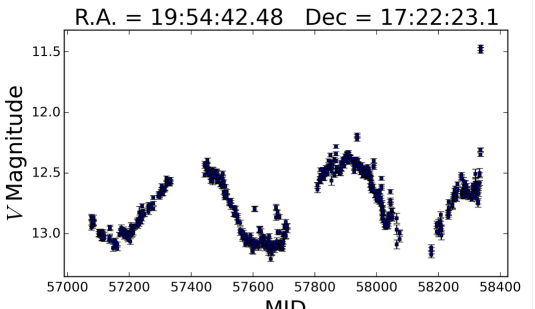

Robert Fidrich has this newly found variable star ("Vend S955") already on his observing plan for a longer time, here is his light curve:
A fresh Vmag is 10.85V (observer: Tamas Tordai) so it may have stopped.
- Peter
EDIT: this light curve is from ASAS-SN

Clarification post by Robert Fidrich:
Some clarification.
I found this star in outburst during our "Vendégcsillag-kereső" (Gust Star Hunter) nova patrol programme. There was a sudden brightening in a few days - in contradiction of the original semiregular variable (SR) classification based on archives ASAS-SN photometry.
The light curve attached by Peter on the forum was not made by me, but the can be generated/downloaded through the ASAS-SN website:
https://asas-sn.osu.edu/light_curves/75 ... 030b616a2d
https://asas-sn.osu.edu/light_curves/cd ... e1b32f1ca2
So this was originally classified as SR variable - not a Mira.
It's realy exciting to catch a new symbiotic variable in it's firts know outburst.
Thank you for your fast reactions!
Clear skies,
Robert

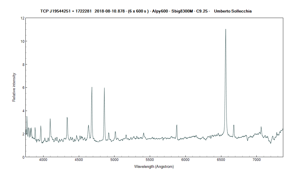

Re: ASASSN-V J195442.95+172212.6 10.7V mag in Sge
Post by umberto sollecchia »
Bonjour à tous, voici ma contribution en basse résolution. Umberto
