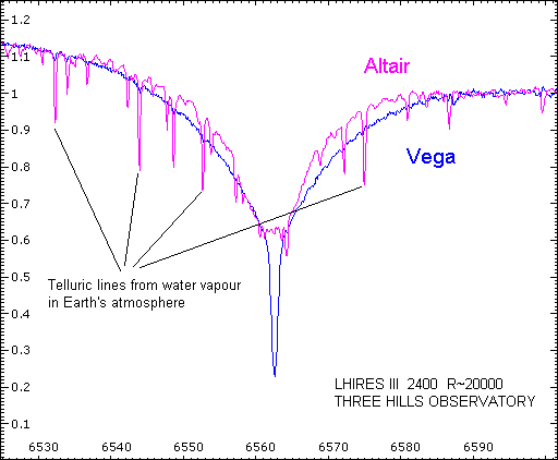

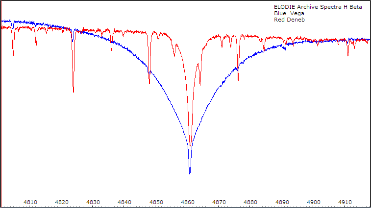

Re: Raies spectrales O B A F G K M
Hello Benji,Etienne
Rotation dominates the width of the metal lines but surface gravity (pressure) dominates in the Balmer lines. Rotation just removes the sharp core of the line.
Vsin(i) effect
g effect
Post by Benjamin Mauclaire »
Hello Robin,
Your comparisons are impressive.
You are right, Vsini affects more metallic lines than Balmer ones.
As usual Balmer lines are the melting pot of many phenomenon and Vsini hasn't spectacular effect on it.
To complete your demo, here are numerical values (from https://en.wikipedia.org) to understand line shape in the spectra you provided:
Star : Type : Teff : Vsini : g (cgs) : R (Ro)
Altair : A7IV-V: 8000 : 240 : 4.29 : 1.6-2.1
Vega : A0Va : 9500 : 20.5-236e: 4.1 : 2.4x2.8
Deneb : A2Ia : 8400 : 20-30 : 1.1 : 203
And congratulations for your last paper (MNRAS 000, 1–13 (2018)) about eps Aur!
