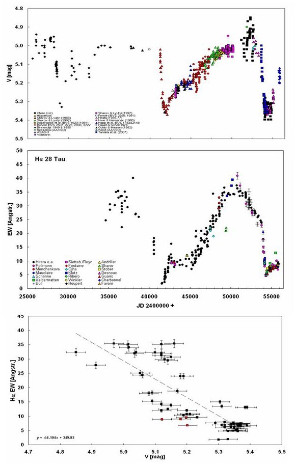

Halpha and V correlation in 28 Tau

Post by Ernst Pollmann »
Some new spectra of ARAS observers (data base BeSS: Houpert, Favaro, Buil, Mauclaire) and visual brightness measurements with DSLR camera (red square, W. Vollmann, BAV-Germany) did enable to extend the correlation between Halpha EW and V of the Be star 28 Tau (see attachment).
Halpha EW versus V.jpg (74.64 KiB) Viewed 3151 times
