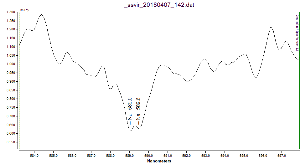

I'm sure that I don't completely understand the concept of resolution, but I was asked how, with such low resolution, I could observe small values and small changes in the EW of Balmer lines.
I also don't think that if my resolution was 500, that I should be able to resolve the sodium doublet. Is that correct? Here is the sodium doublet that I observed in SS Vir
13 Vir sodium doublet.png (14.73 KiB) Viewed 14062 times
Can I use the sodium doublet to calculate the resolution? Are there any other lines that I could use?
Thanks.

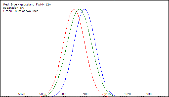

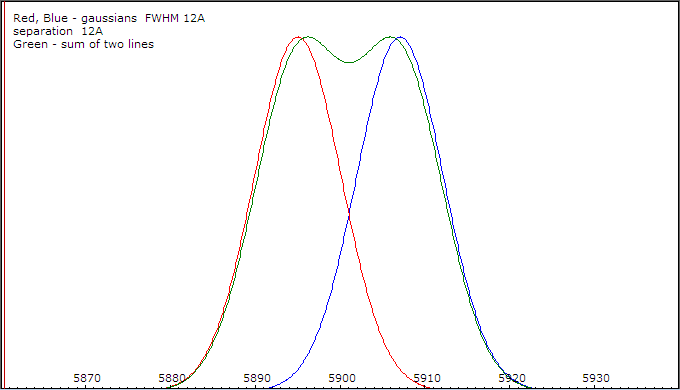

This is an interesting question. Theoretically you should not be able to separate these 2 lines with the ALPY at a resolving power of 500 (12A resolution at the Na D lines) but there is some sign of a split in your spectrum. We can simulate this by taking generating two synthetic gaussian line profiles with a 12A FWHM using ISIS and summing them at different separations.
At 5A separation there is clearly no split but at 12A separation we just see a split, confirming that the FWHM of the line is a good indication of the resolution. (The separation at which two lines can be resolved) This does not explain though why there is apparently signs of the D lines having been split in your spectrum, which is surprising. Perhaps it is just noise, perhaps the lines are not gaussian ? Can anyone offer any other explanation ?

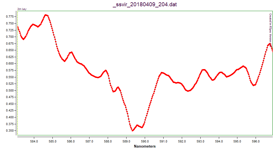

I do use the calibration lamp. The resulting calibration spectrum was used when I processed the spectrum with ISIS. I observed the star 2 days later and calculated a resolution power of 551.5. Here is the image from that day, with the data points labeled in red. I think that the data is well sampled and the peak between the two minima is not just due to noise.

My question is that when I use the calibration lamp, the lamp fully illuminates my 23 um slit and I presume this impacts the resolution calculation. However, given my 2.4 um pixels, my 6" f/6 telescope and the (sub)arcsecond seeing that I can get here in Florida, often a star is maybe 1/3 the width of the slit. Could it be that the the calibration lamp, with its wider lines, is underestimating the resolution of my smaller star images? Could the sodium D1 and D2 lines provide an estimate of the resolution of the system? Thanks again.

On your spectr, i think you have double pic absorption on the absorption ray at the right of the NaI, No ?
Possible it's the small pixels of the 178MM amelior the resolution ? but with a slit of ALpy 23µm and resolution of 551 i dont know if it's possible to separat NaI?

James Ley wrote: My question is that when I use the calibration lamp, the lamp fully illuminates my 23 um slit and I presume this impacts the resolution calculation. However, given my 2.4 um pixels, my 6" f/6 telescope and the (sub)arcsecond seeing that I can get here in Florida, often a star is maybe 1/3 the width of the slit. Could it be that the the calibration lamp, with its wider lines, is underestimating the resolution of my smaller star images? Could the sodium D1 and D2 lines provide an estimate of the resolution of the system? Thanks again.
Yes I think this is the answer. If your guiding is good, you could get a higher resolution than the width of the slit. I now remember someone else seeing this (You are effectively running slitless). The problem is the resolution will be unreliable as it will depend on seeing and guiding. You will also get small shifts in calibration depending on exactly where in the slit the star is located. You should probably consider using a narrower slit which will give you a higher, more stable resolution and a stable calibration (Or a larger aperture scope of course :D ) I am very envious of your sub arcsec seeing !
