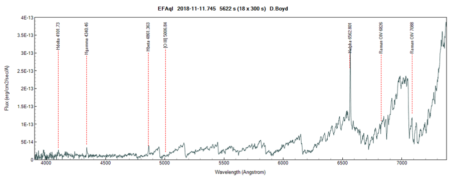

According to the ephemeris in VSX it is now close to its maximum brightness and therefore reasonably accessible to low resolution spectroscopy. The spectrum below is a 1.5 hour integration recorded on 2018 November 11.75 UT using a LISA spectroscope and SXVR-H694 camera. Its V magnitude was measured as 12.79 concurrently with the spectrum and used to flux calibrate the spectrum.

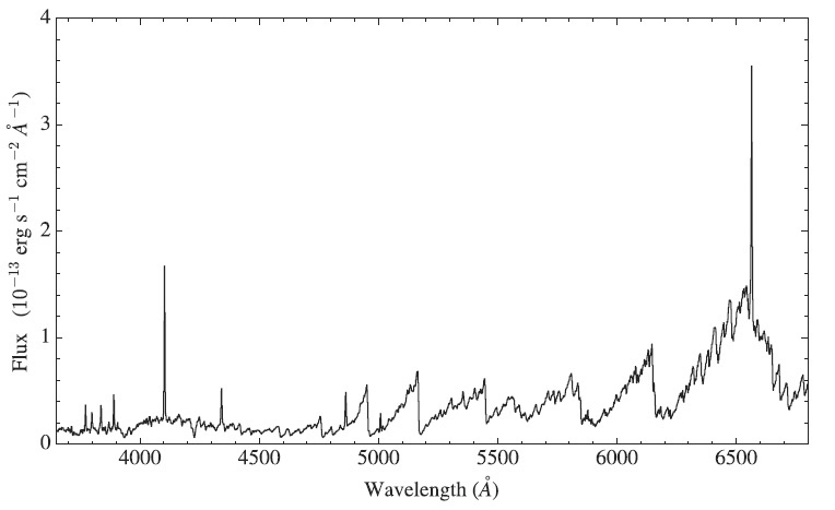

Comparing this to the spectrum below which is Figure 1 in the Margon paper and was recorded in 2014, the flux level is very similar but there are significant differences in the emission lines.
Margon et al. Fig 1.jpg (51.23 KiB) Viewed 3332 times
The H-delta line which was prominent in 2014 is barely visible now. Also the [O III] 5007Å line seen before is now absent. The Margon spectrum cuts off at 6800Å before the Raman OIV lines but neither the OIV 6826Å or 7088Å lines are apparent in the current spectrum.
The spectral profile of EF Aql is a good match to spectral type M7III. Margon estimated the extinction to EF Aql to be Av = 0.45 so the correction for interstellar extinction is small enough not to change this inferred spectral type.
