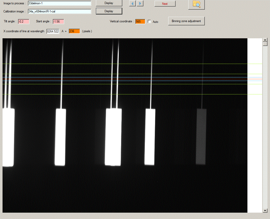

Re: Isis Infrared processing config of LISA
Hello James,
Don't know if it helps, here is my calibration file for LHires 600/mm visual (R~2700):
CALIB\g600_IR_CaIImid.lst:
2
0.72806580645161290322580645161292
8103.693
8115.311
8264.522
8408.21
8424.648
8521.442
8667.944
Many of these lines should be resolved by LISA (some little contamination at lower res more and more likely to happen, so you either include many of these, or include very few but very sure ones).

Calibration image:
If you chose manual calibration via file, first I recommend you to calibrate the lamp image with itself (copying and renaming appropriately). Don't forget checking 2.General -> Sky not removed. Then load the first few attempts (processing with order=1 and few lines for the very first attempts) in VSpec and see how the lines fit visually: play with Tools -> Elements / Lineident dropdown list. You can get extra lines upon your wish, and finetune the calibration (I know, this is not easy but can be done once).
