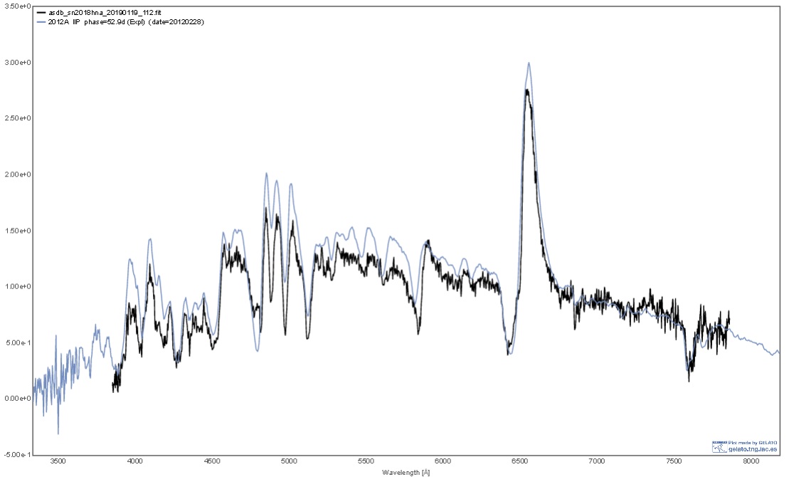

After almost 2 months of this SN's discovery, last night I've put it on the list as the 2nd larger target for the case if weather allows (30 cm f/4 Newton, Alpy 600, 18 micron slit, ATIK 414, 3 x 1800 sec, 2019.01.19.112, R~670), cutting Gelato's comparison as the 2nd match:
Gelato says 100% type II, however much more type IIP matches. With SN2012 (Type IIP) it estimates phase~50d that is close to the reality, with 1st match 1994N (Type II only) it tells 35.6d. Looking at these matches, my speculation that it's more like Type IIP, though not understanding classification system enough yet.

Hi Peter,
Nice spectrum. It is a good reminder not to forget supernovae which are discovered early when faint. I think this must have been an unusually bright type II.
(EDIT I misread the z for this galaxy (it is faint but nearby) so the brightness now is in fact fairly typical of a type II at maximum brightness at this distance)
There was not enough evidence in my spectrum to decide if it was a normal type II or a possibly an early IIb. Others on TNS also classified it as type II but it is not clear if they eliminated the possibility of a IIb. Your later spectrum eliminates a type IIb which show only weak Hydrogen lines. IIP (plateau) are most easily distinguished by their light curve which has a pause. I have not looked at the light curve but I suspect since it is still bright after 2 months is could well be a IIP

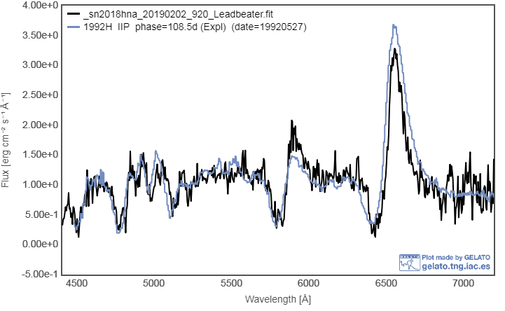

Despite its unusual very slow rise to maximum (~80 days) , the spectrum still closely matches match that of a normal type IIP SN at the same age. See attached ALPY 600 spectrum and example GELATO match

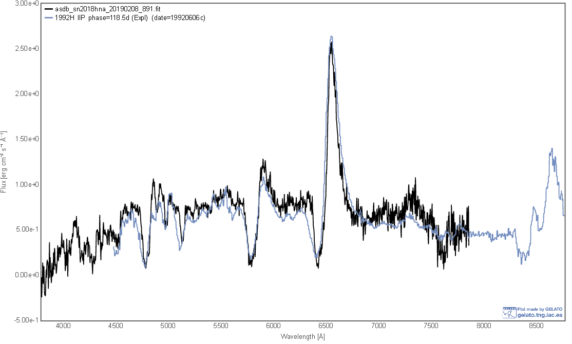

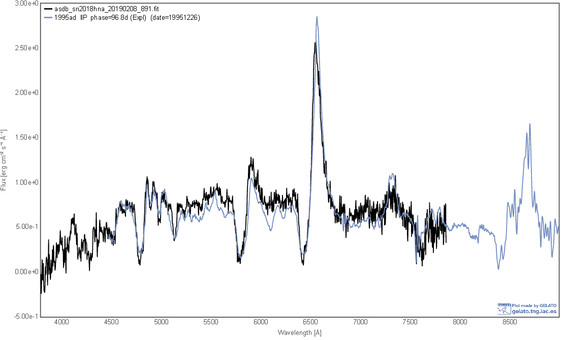

Here is my result (6 x 1800 sec) from last night, after spending 3 weeks without usable weekend-sky:
Althoguh Gelato offers the SN 1992H IIP even to me as a first match, I believe the Balmer velocities - with the blue end altogether - matching so perfectly, unlike 1992H that is showing well elaborated RV differences.
1995ad telling Phase=96.8d, whilst the 1992H match shows Phase=118.5d:

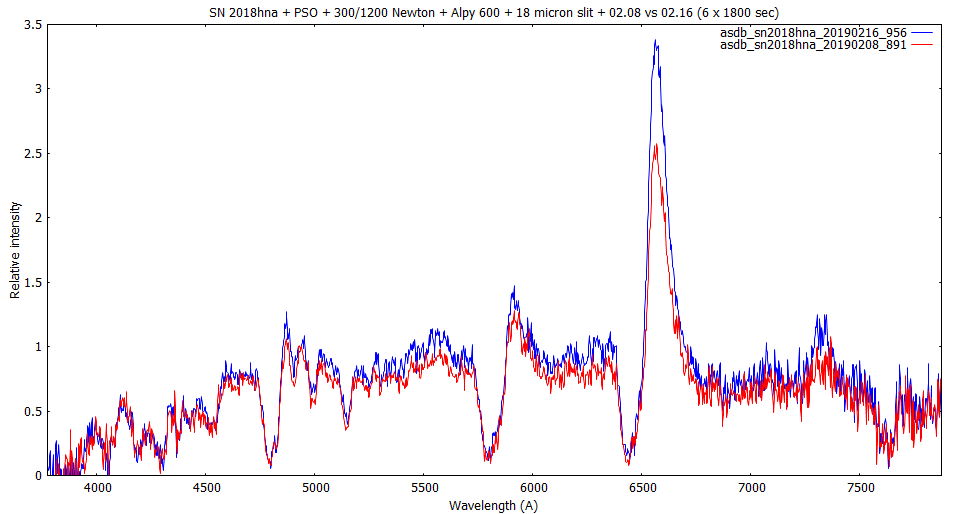

Re: SN 2018hna
Fresh result from this weekend, no big change except the H-alpha peak increase:
- Peter
