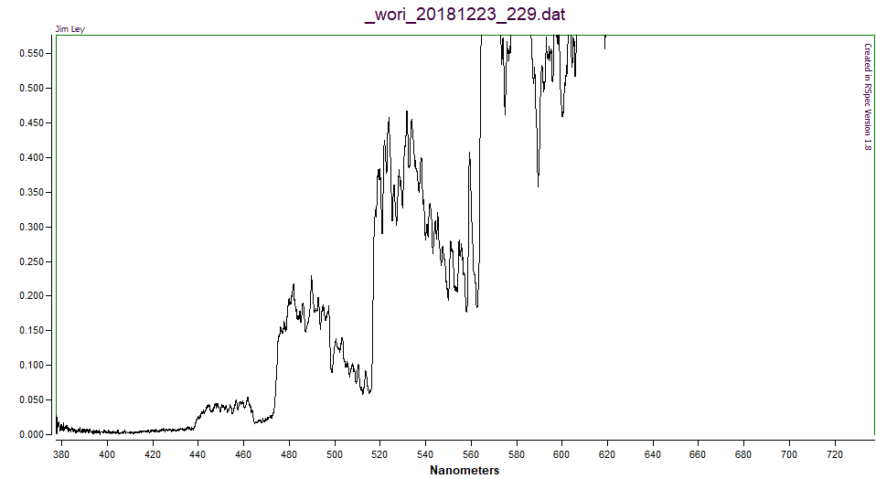

For some comparison, here is a spectrum of W Ori with ASI178MM-Cool (monochrome). 0.150 m telescope, 1 x 40s. Alpy with 23 µm slit.
W Ori 1 x 40s.png (13.96 KiB) Viewed 8565 times
That is less than 1/10 of the time of Christian's spectrum!

To show that the comparisons are difficult, and also to show the potential of the new sensors, below, my color spectrum of W Ori by retaining only one image of the sequence, i.e. an exposure of 60 seconds only. My telescope is bigger (235mm vs 150mm), but my seeing was very bad. But also, I admit, the optical performance of UVEX is a bit higher than that of Alpy:
...remember that only 1 / 4 (approximately) pixels records light versus a B&W sensor. As we see James, the result is quite comparable with your spectrum. It's a significant information I think (but again, this type of comparison is difficult, there are many parameters that come into play).
