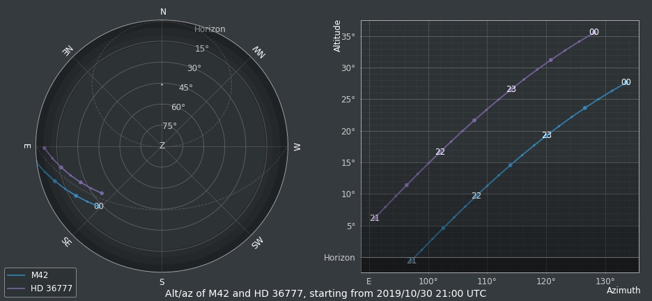

I added charts of alt/az of target and reference star over time (1h before, 2h after observing time), some other information (if sptype is in PicklesDB, etc...). Charts are made with Matplotlib.
Alt/az over time
Alt/az over time
Let me know if you find any bug or would like another functionality.
