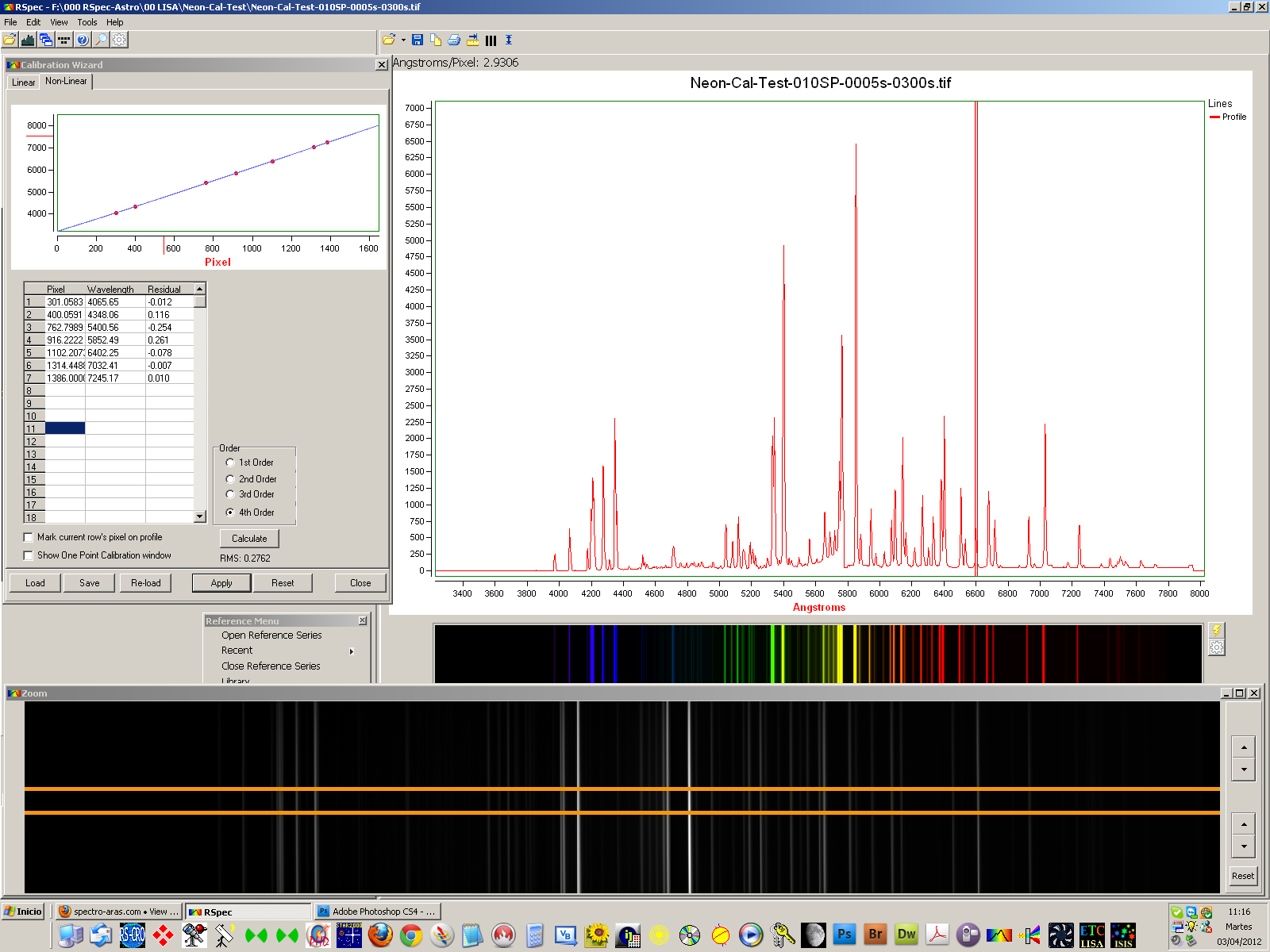

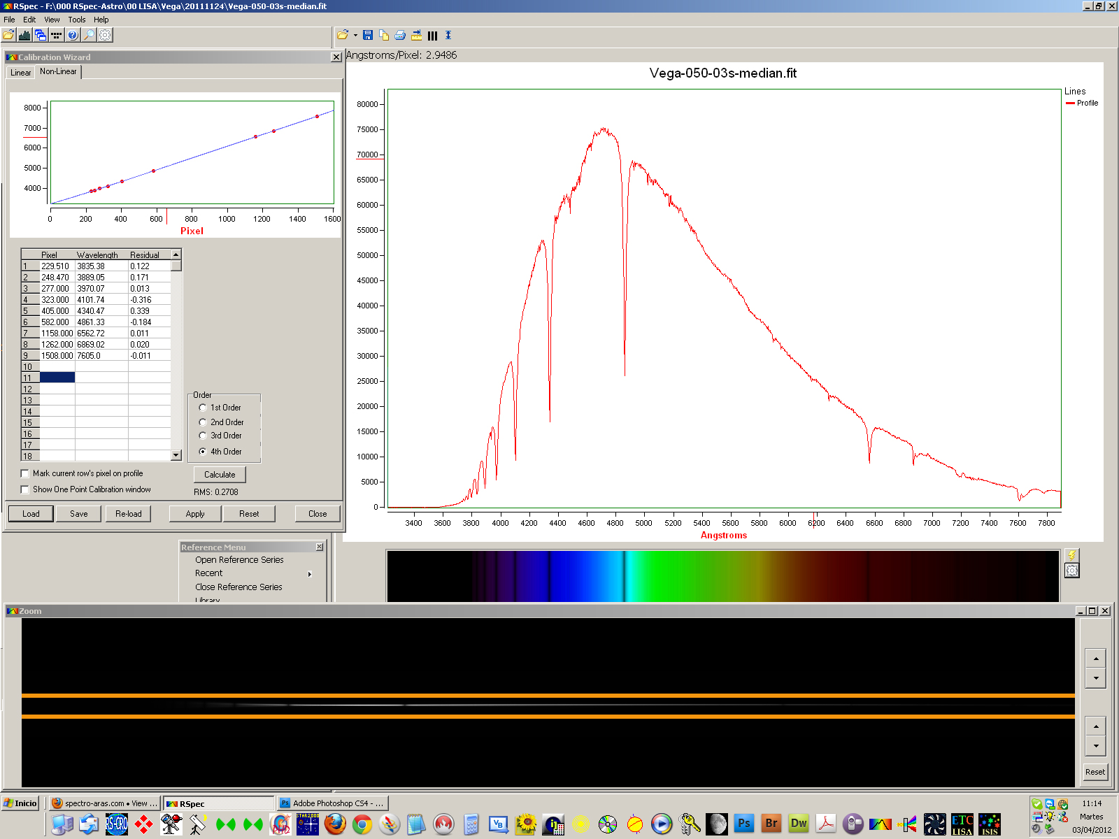

Finally I was able to test the calibration proposed by Benji.
I made 10 Neon images with 5 seconds and 10 images with 300s and then stitched them together. Then I analized it and the result is quite good from my point of view as I compared with an equation I use made on Vega.
If I have the opportunity I will test the calibration method on various stars.
Below you can see both results.
Integrated Neon calibration lamp in my LISA spectrograph with 35µm slit.
Vega calibration

Rainer Ehlert
Posts: 135
Re: Low resolution calibration method
Post by Rainer Ehlert »
Hi Francois,
Which spectrum do you refer to ? Combined Neon ? If yes please download from this link
http://astroforo.net/astro/rspec/LISA/N ... s02762.dat
and here the combined Neon image *.fit file
http://astroforo.net/astro/rspec/LISA/N ... s-0300.tif
I used the 35µm slit.
regards Rainer

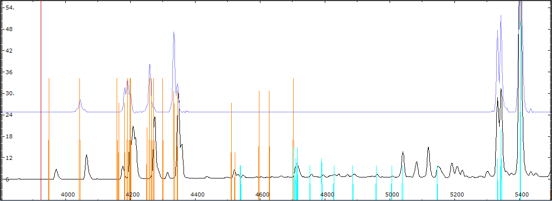

Hi Rainer,
I think there's a problem.
Your lines don't match with the theorical ArI lines given by VSpec.
I took a 120 sec spectrum of the neon lamp. Divided by its "continuum". Wavelenght calibrated (ISIS)
Your spectrum : black
Mine : blue
ArI : orange
NeI : cyan
Neon lines near 5400 match correctly
I'am taking another spectrum, 600 secondes exposure in order to get the weak lines.
I'll keep you informed
All the best
