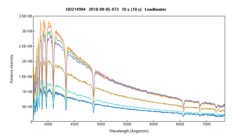

Yes this is a serious question :-)
The AAVSO have just opened their spectroscopic database and published a manual for amateurs doing spectroscopy
https://www.aavso.org/apps/specdb/help
There is a lot wrong with this manual and their Fits header specification but a particulalry important issue is flux calibration
There they say that flux calibration (they do not distinguish between calibration in relative and absolute flux) can only be performed in photometric sky conditions and they recommend amateurs should normalise (rectify) their spectra before submitting them to their new database. This is of course different to the many thousands of amateur spectra already in the ARAS, BAA,BeSS databases.

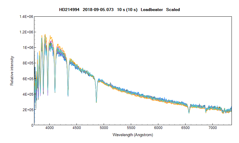

It is true that accurate absolute flux calibration of spectra (in physical units) needs photometric conditions and a photometric slit (unless scaling using an indpendent magnitude measurement) but is this really true for relative flux calibration ? (ie the method normally used by amateurs, correcting for instrument response and atmospheric extinction using a reference star.)
I found some measurements of a reference star which I made under variable cloud conditions. The flux in the individual exposures varies by a factor of over 3x but after rescaling the spectra agree to better than +-10% so it would seem calibrating in relative flux is possible to reasonable accuracy even in extremely poor atmospheric conditions. (see the attached plots)
