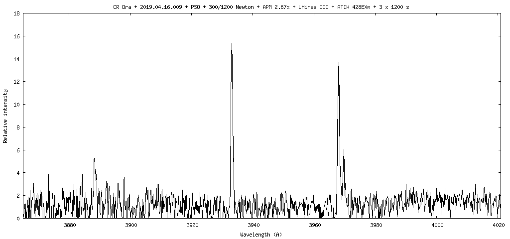

On 04.15, I've been shooting repeats of stars Christian mentioned, attaching as a zip (so everyone can compare). No heliocentric correction made.
One of the interesting repeated star of SNR perspective, but here with the LHires + 35 micron and a 12" scope:
As one can see, H7 and H8 peaks also present. Continuum available reliably only towards 4000A.

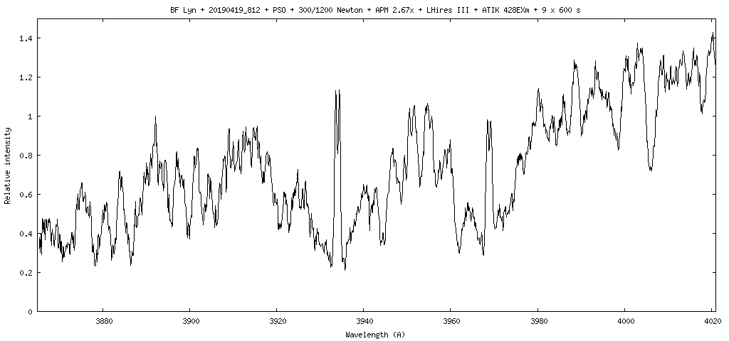

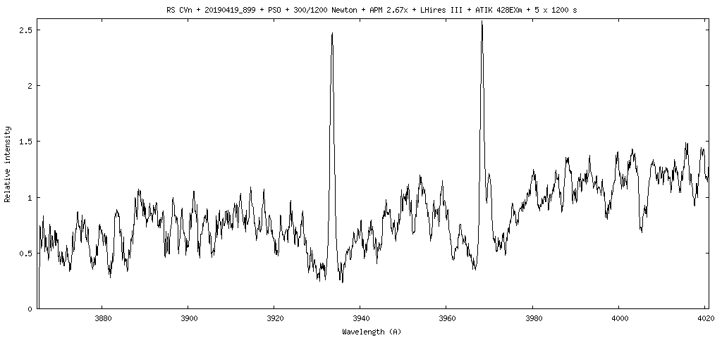

From yesterday(04.19), two of these targets (none of them easy):
In case of BF Lyn, H & K emission cores are well separable (depending on period), coming from the binary components.
H7 or other emission also present (requires deblend procedure to measure).
I have started a process getting through a 1st validation at aavso (unsure when to happen - and what else required), so pls take all of these quick results as preliminary / demonstrative.
I was using ref.star from Pickles (order 3 polynom everywhere), using BLB flat in 1D (removing few emissions), doing Ar/Ne lamp. Made no heliocentric correction in these examples.
