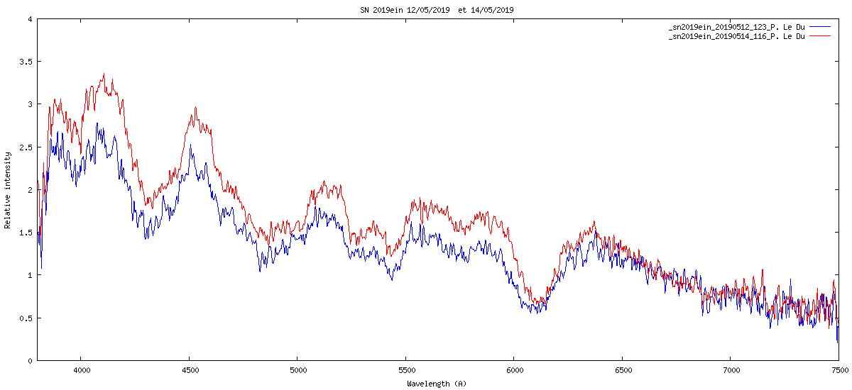

Bonjour

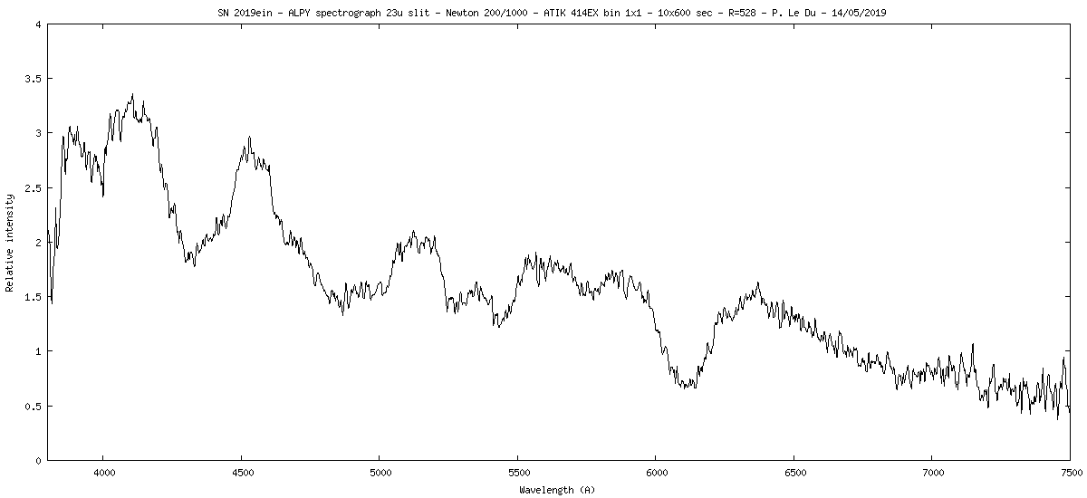

J'ai pu saisir de Bretagne très tôt ce matin, le spectre de la supernova SN 2019ein qui est est maintenant bien visible dans la galaxie NGC5353.
Matériel utilisé : Newton de 200mm à F/D 5, Alpy600 avec une fente de 23µm et CCD 414EX.
Temps de pose: 7x600 sec
D'après la littérature, le spectre est assez complexe à interpréter donc je vous laisse m'expliquer un peu ce qui se passe...
Hello
I was able to observe from Brittany early this morning, the spectrum of the supernova SN 2019ein that is is now well visible in galaxy NGC5353.
Used equipment: Newton 0.2m to F/D 5, Alpy600 with 23μm slit, CCD 414EX binning 1x1
Exposure time: 7x600 sec
According to the literature, the spectrum is quite complex to interpret so I let you explain a little what happens ...

Spectre 1D SN 2019ein
Amicalement
Pascal

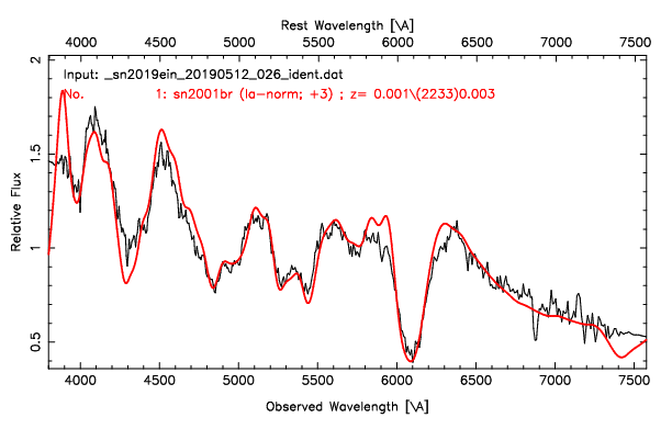

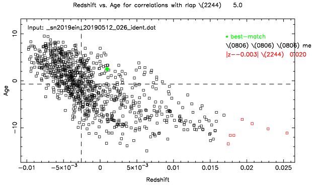

Here is my spectrum from the same night (black curve) overlaid on the best fit from SNID (red). SNID predicts a type Ia at maximum B brightness +-5 days.
The fit to a typical type Ia is excellent but like the Global SN project found in TNS, SNID also estimates a blue shift relative to the published host galaxy redshift (z = -0.003 +-0.006 compared with 0.008 for NGC5353 from NED). I understand estimating redshifts from supernova spectra is not very accurate though
Posts: 1041
Re: SN 2019ein
Hello Robin,
I dont understand, why Snid dont find a reshift near 0.00775 ?
0.003 is too little no ?
Re: SN 2019ein
Hi Etienne
etienne bertrand wrote:Hello Robin,
It is not easy to measure the redshift from a type Ia supernova spectrum. All you have are very broad absorption lines which are blue shifted by the velocity of the explosion. This velocity also changes with time. SNID tries to estimate the redshift and age of the supernova by matching with known supernovae spectra but the solution is not unique so the errors can be large. Attached is the age/redshift graph from SNID and the predicted most likely redshift and age for this supernova. There are also a few possible fits at 0.0078 redshift though.
There might be something peculiar about this supernova as the original classifiers suggested on TNS (an unusually high velocity of the explosion) which might be the reason for the redshift error. Also the published galaxy redshift is probably measured in the nucleus and this supernova is at the edge of the galaxy where the velocity could be different.

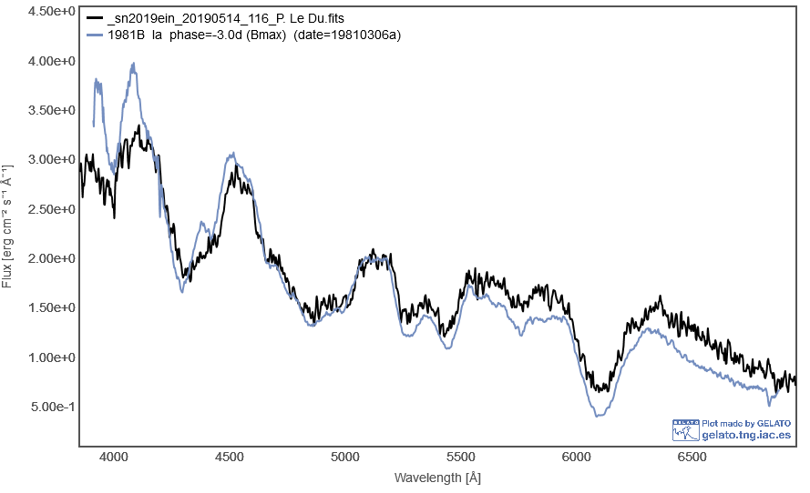

Thank you Robin for all these explanations. As you show, the determination of the redshift is difficult.
I was able to observe SN2019ein again last night.
Here is the result ;
SN2019ein spectrum 14/05/2019

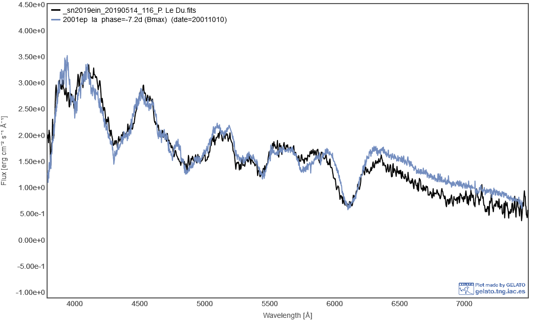

GELATO comparison 1981b -3 jours
GELATO comparison 2001ep -7.2 jours...

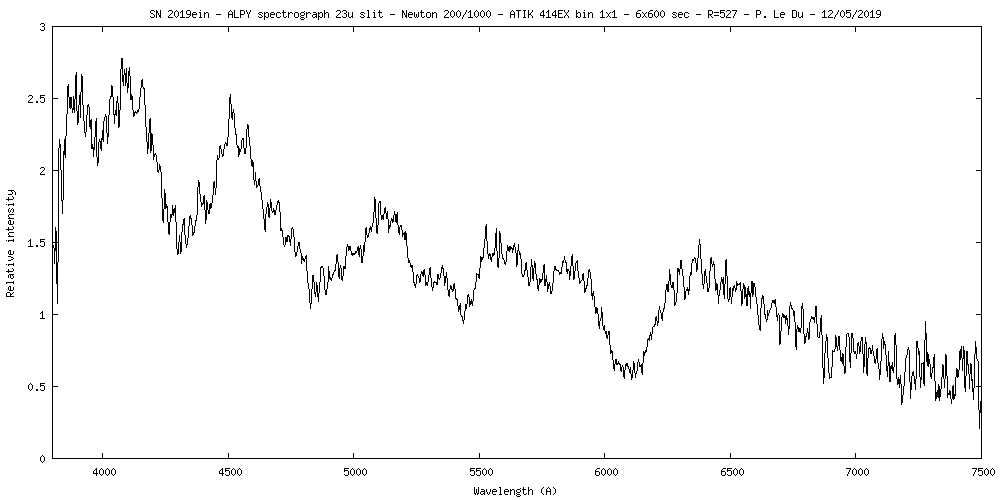

Evolution between the 12/05/2019 and the 14/05/2019
Could you tell us more about this SN?
Pascal

15000km/s is unusually high for a type Ia at this age. See here for example
https://www.researchgate.net/figure/Com ... g2_1794514
This is why SNID is suggesting a much lower redshift.
