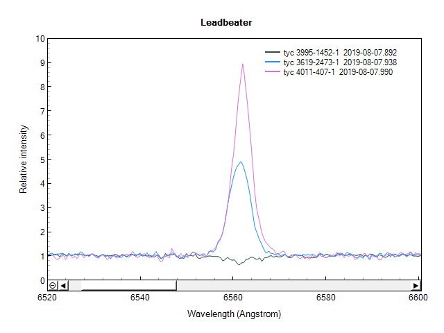

Here are a couple of interesting ones so far

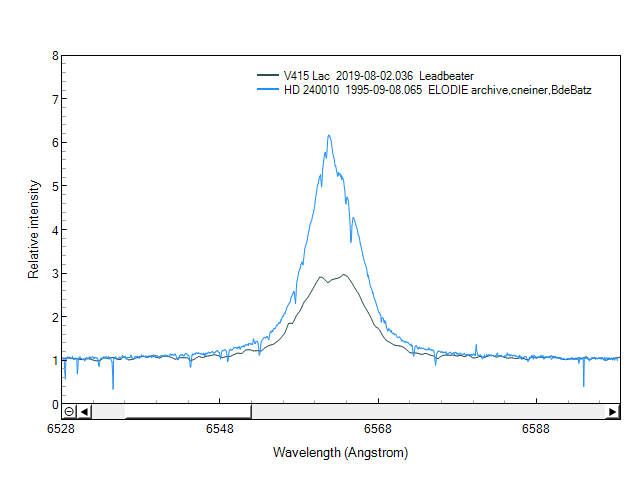

V415 Lac (Vmag 9.2) was last measured in 1995 ! The EW of the H alpha emission now is approximately half that in 1995

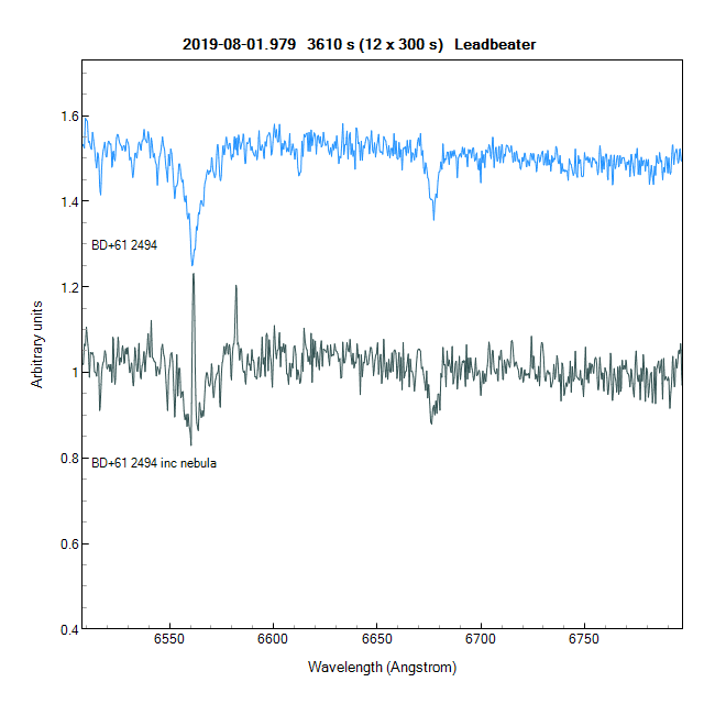

bd+61 2494 (Vmag 10.0) has no previous spectra in BeSS. The star itself currently shows no emission, but it is embedded in an HII region and the sky background shows H alpha

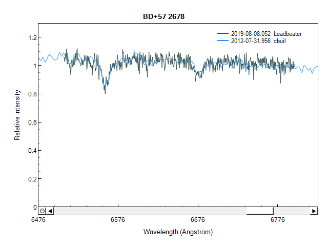

BD+57 2678 has only been measured once before (at low resolution) in 2012. The spectrum looks the same

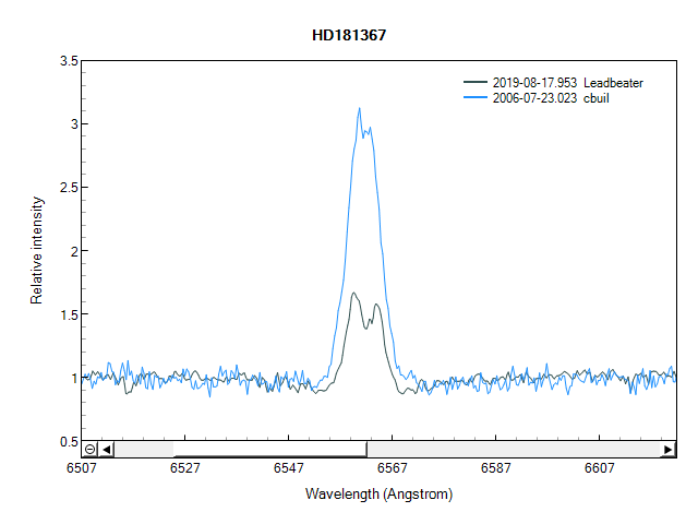

HD181367 has only one other spectrum from 2006. The H alpha intensity is now significantly lower (EW ~1/4 of what is was then)

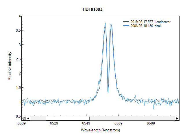

HD181803 is unchanged from 2006. (There is also a low resolution spectrum from 2013 which has ~ the same H alpha EW) so this one is probably be long term stable.
