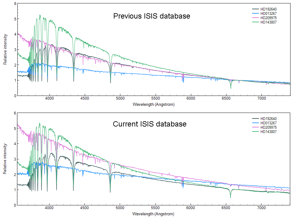

In the previous version of the ISIS database, MILES star spectra had all been normalised (intensity set to unity) at the same wavelength. In the current version of the database, this is no longer the case and spectra have been normalised at different wavelengths.
Miles star profiles.png (143.45 KiB) Viewed 2498 times
A consequence of this is that the compare function in ISIS may not align the target and reference star spectra at the same level in intensity, unless the two spectra happen to have been normalised at the same wavelength. While the normalisation wavelength of the target spectra can be set by the user, this is not the case with the MILES spectrum. This makes the compare function much less useful.

I suspect this may be because the current database is based on the Interstellar Extinction corrected spectra from MILES which were then reddened but perhaps not rescaled. The original database used the original MILES non IS corrected spectra.
E(B-V)
HD192640 0.03
HD013267 0.42
HD209975 0.39
HD143807 0.02
