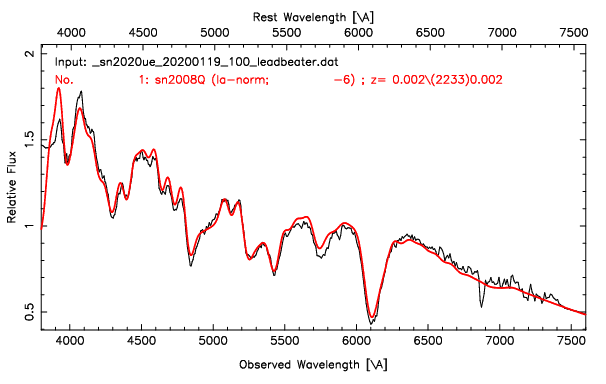

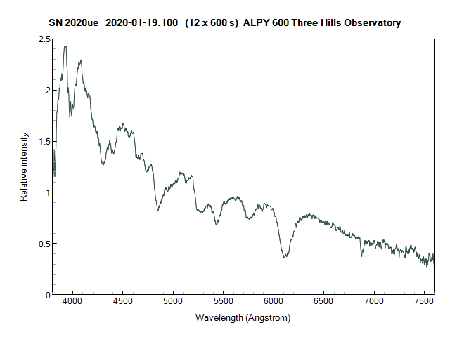

Here is a high SNR spectrum from last night using the ALPY600.
which gives and excellent detailed match in SNID to several type Ia supernovae still a few days from maximum eg

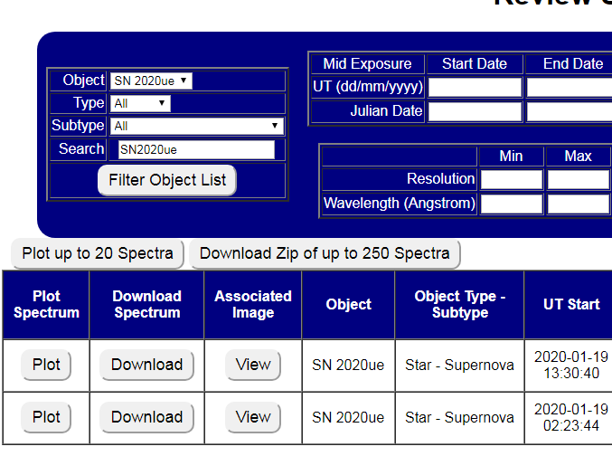

Re: potentially bright supernova in NGC4636
Hi James
Note the correct designation is SN 2020ue not SN2020ue (mind the gap ! I sometimes forget too) I had already registered SN 2020ue as a new object in the BAA database so I have added SN2020ue as an alias so either designation will now call up all the spectra
