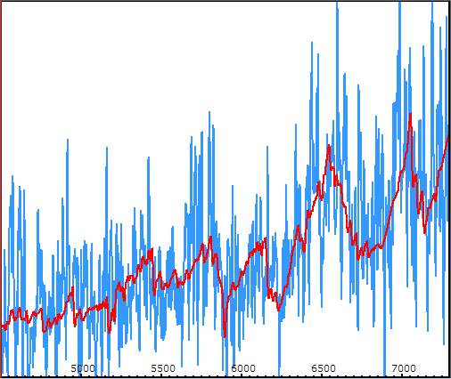

An extremely noisy (SNR~3 :o ) ALPY 600 spectrum last night suggests an M type star (M3?)
Red - Pickles M3v

Well done on such a faint star Robin, even with that SN ratio it looks fairly conclusive.
Regards Andrew
Re: Call for observation for a new variable star
Thanks Andrew,
It was much harder than I expected. I recorded SN 2020ue at mag 14.5 and higher air mass the same night and got an SNR of ~30 so at mag 16 I expected an SNR of ~15. Either it is a fair bit fainter than that or the bright moonlight had a greater effect.
OK I see on the astrosurf forum it has been remeasured at V mag 17 (though brighter in the red) so this is the faintest object I have recorded with the ALPY in its standard configuration.

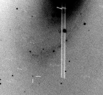

Here is the guider image
