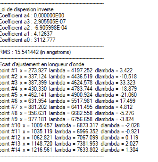

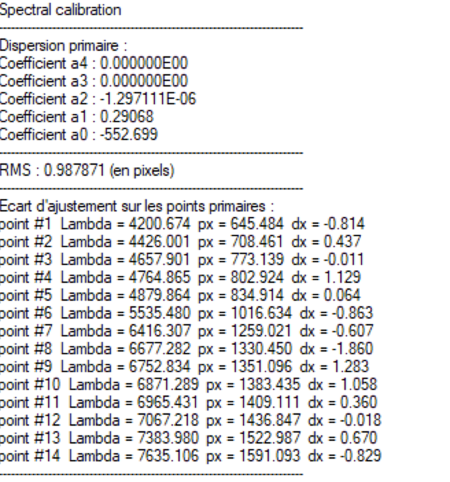

Here are some screenshots that may help showing what I am encountering:
(I have the screenshots in reverse order - but you should be able to see the issue)
The RMS flips from 0.98 to 15.5 for the inverse multiple times till the profile is generated. This is with the Predefined mode for the LISA - the same result with Ar IR, Ar Visible and Neon. I can't refine this with the Calibration Assistant as it generates a RMS of about 5 (or 8) and reports it as too high. The response curve generated with the Response Assistant is also unusable.
There may be a simple setting I am missing but I can't find it - the pixel size is correctly set at 9.08 for binning x2 (up from 4.54 for this camera).
Has anyone ever seen this?
Pete
Pete
- Screenshot 2020-05-21 13.55.27.png (269.83 KiB) Viewed 12756 times
- Screenshot 2020-05-21 13.55.11.png (284.15 KiB) Viewed 12756 times
