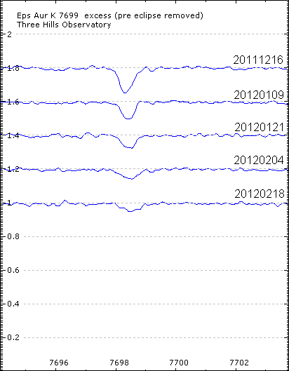

The excess absorption at 7699A from neutral potassium has now reached the same level as when I first detected it above the noise on 24th May 2009 (0.03A EW) See attached for the evolution over the past 2 months. Eps Aur is better placed currently though and my equipment has improved over the past 3 years so it should be possible to track it a bit further before it finally disappears into the noise.
eps Aur excess K absorption at 7699A  Dec 2011 - Feb 2012
