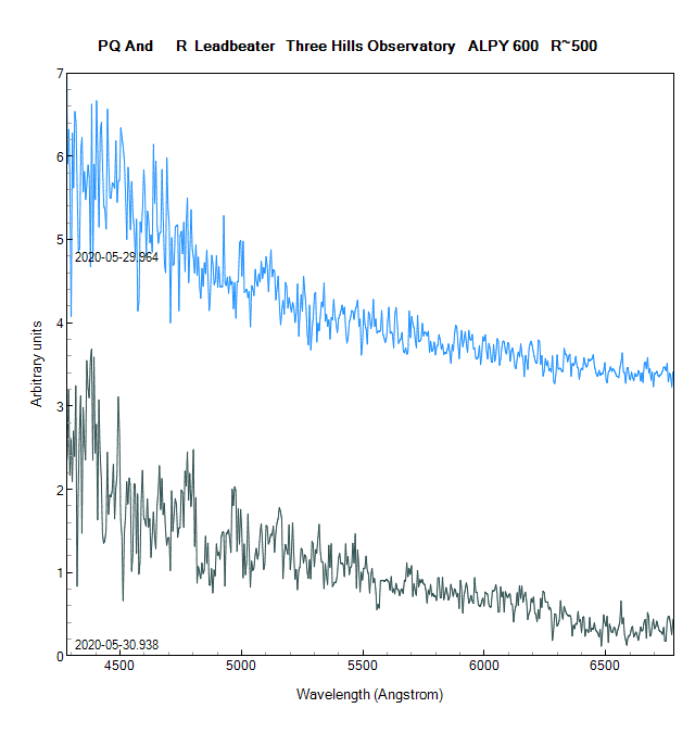

I managed a couple of spectra taken under very extreme conditions, mag 10.5 in a bright summer night sky at just 5 deg altitude (air mass 10 !)
There is not much in common between them apart from the hot continuum so I suspect the smaller scale features are just noise

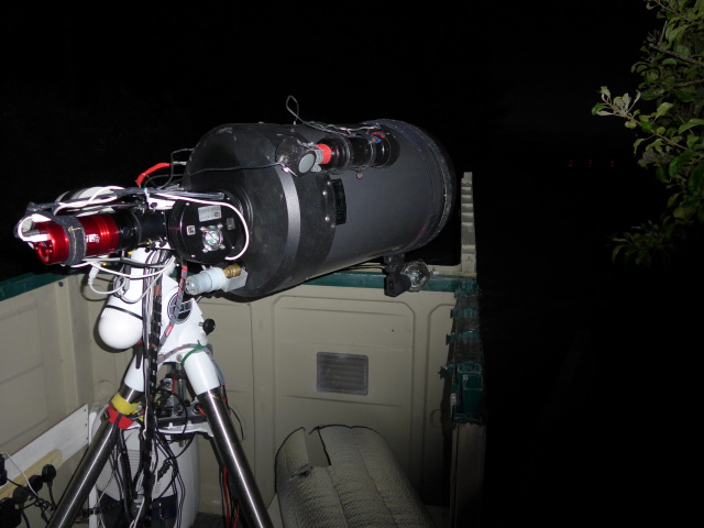

This was the setup

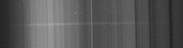

and this is a (reduced scale) raw spectrum image (note the curvature in the spectrum due to atmospheric refraction)

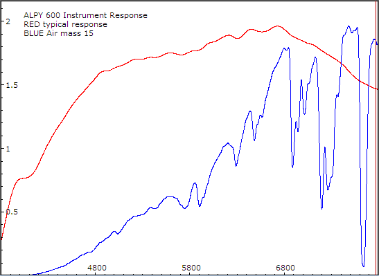

As an experiment I went even lower and observed 58 And at air mass 16 (2.5 deg Alt) This was the instrument response (including tellurics) at that air mass compared with a more typical curve. As well as the usual O2, H2O telluric bands, the overall broad dish shape in the response and the features either side of ~5850A caused by the Chappuis ozone absorption band are particularly noticeable

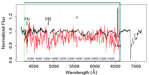

A professional spectrum has now been published taken 2020-06-03 which shows a typical dwarf nova spectrum ( Broad Balmer absorption lines with superimposed narrow emission lines)
http://www.astronomerstelegram.org/?read=13776
Although noisy, my rectified spectrum for 2020-05-30 (red) overlaid on the published spectrum (black), shows H alpha emission present and a hint of the H beta absorption with an emission core
