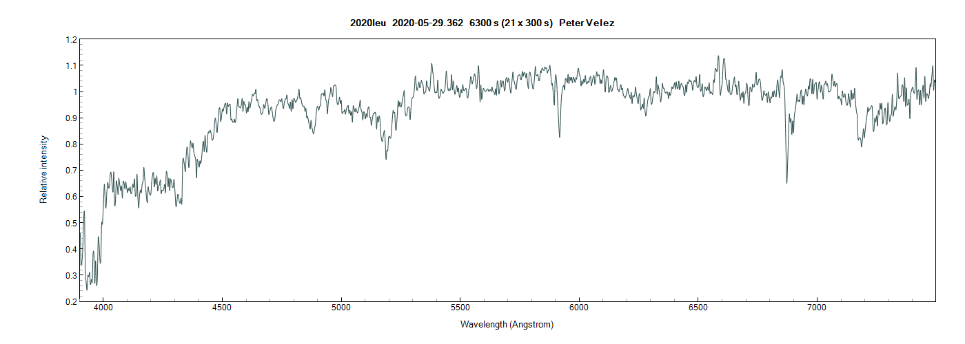

Managed to image 2 supernovae last night.
2020leu was reported on 27 May 2020 and observed on 24 May. It appears to be in NGC 5363 which has a reported redshift of 0.0037. No spectra are available as yet and it hasn't been classified either.
Here is a spectrum taken from 21 x 300 s images binned x2 through a LISA using a 23 micron slit (again, likely undersampled - one of the joys of imaging remotely is its not so easy to change the slit or tweak the focus). Taken with an ATIK 460EX mounted on a PW CDK 12.5 from the iTelescope facility at Siding Springs Observatory.
Gelato suggests this is a Type II SN but its an unreliable classification - given how noisy the spectrum is, that is not surprising. This target is reasonably well positioned for me to devote several hours to it so, weather permitting, I'll have another go this evening.

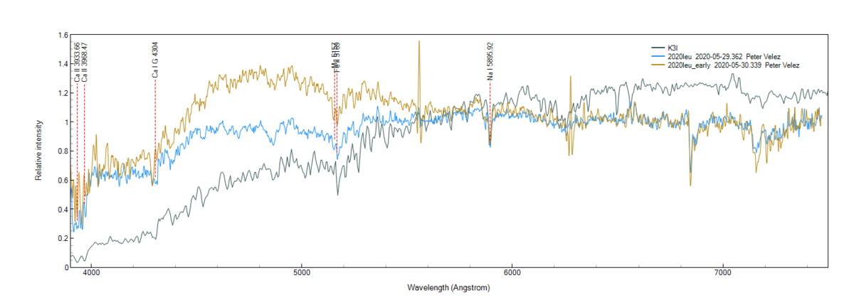

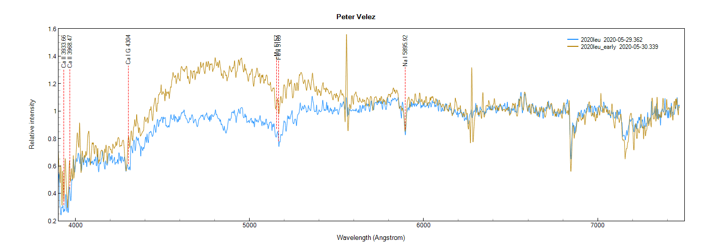

I took another 2 sets of spectra of the target last night - because clouds came and went I only managed one set early in the evening when the target was quite low and another near the meridian. The later images weren't particularly clear so I have presented the spectrum from early on 30 May and another spectrum from the previous day.

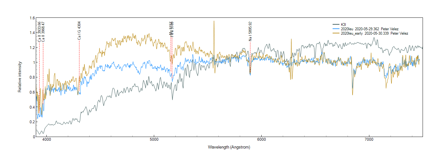

Robin suggested a comparison with a standard K star which was a reasonable match. Adjusting for the reported RV of NGC 5363, I was able to match up quite a few lines with a K3I Pickles spectrum. He also suggested that I might have imaged the galaxy itself rather than the SN target.
I believe elliptical galaxies are characterised by a reasonably flat continuum with a steep drop off at around 4000 A. Prominent absorption lines are often Ca II, the Ca G band, Mg at 5157, Fe II at 5169 and Na I at 5896. Here are the 2 spectra with these lines identified. The spectra have been adjusted for the galaxy's reported RV of 1,129 km/s.
To my untrained eye, this looks like a reasonable match. It may be that there is also a foreground star that I have captured and so the spectrum is the combination of the star and galaxy. I've added the K3I spectrum in a separate plot.
Does this make sense? Comments are welcome - I am still finding my way with both processing and analysing my results.

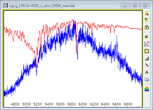

Stellar populations in elliptical galaxies are generally old so the integrated spectrum tends to look like a K star. The galaxy redshift is small but should be detectable in your spectrum so we can use this to distinguish between the galaxy and a foreground star. The Na D line appears to be at the galaxy redshift in your comparison with the redshifted K star but Na can also come from interstellar dust so may not be reliable. A better comparison is the Mg triplet at ~5175A which should be redshifted by ~20A if the target is in the galaxy.
There is a rather poor non response corrected spectrum of NGC5363 in NED
https://ned.ipac.caltech.edu/results?so ... NGC_5363_2
Here it is overplotted with Pickles K3v. The redshift in the Mg triplet is clear compared with the rest K3 spectrum.

- Posts: 1955
Re: 2020leu - Supernova in NGC 5363
Here is a roughly rectified VSpec etc compatible dat file version if you want to compare it with your spectrum. (note it is of the galaxy core so shows some H alpha emission)Robin Leadbeater wrote:
