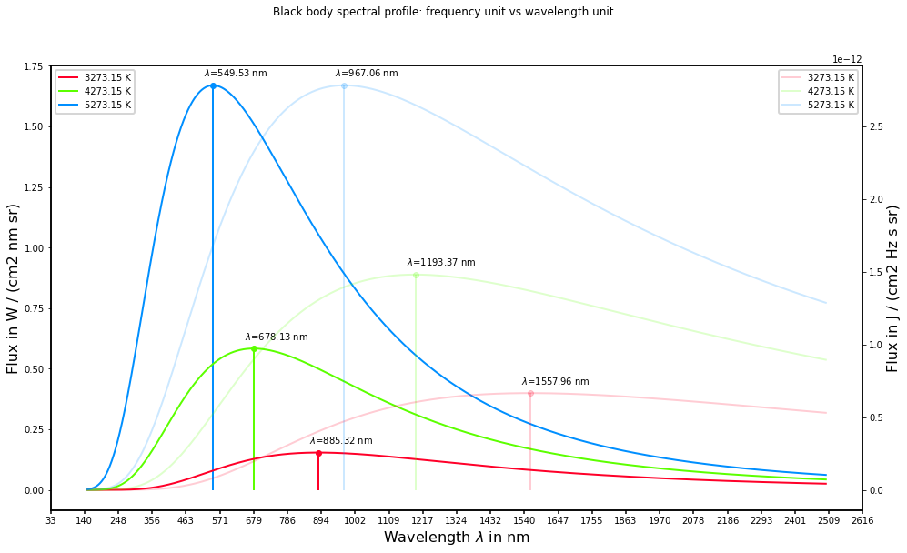

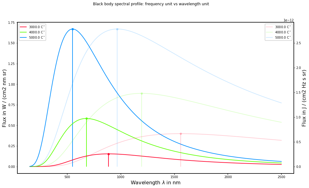

Ok, I think I would share, in case other people might be wondering what is the link between various expression of Planck law (wavelength based or frequency based) that eventually result in a completely different profile.
This is especially useful for people working with astropy I guess, because BlackBody module by default use the frequency based expression. I hereby reproduce an exemple of different profiles that are generated depending on the unit you choose.

Nice graphic.
But temperature's unit has to be corrected to K (neither °K nor °C).
Could you share your Python script?
Benji
Benji

Sure, here is a direct copy/paste:
I need to correct for the celsius unit of the 3 references I took as an example. Otherwise, might actually be worth mentionning that the "frequency" part can be converted esily to Jansky unit (https://en.wikipedia.org/wiki/Jansky).
A more fine grained x-axis would also be worth, in order to have something more meaningful. I'll fix that soon.
