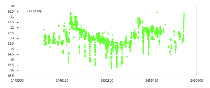

Following a VSNET Alert:
The AAVSO V + Vis lightcurve:
Spectra of the outburst and monotoring of the decrease are very welcome.

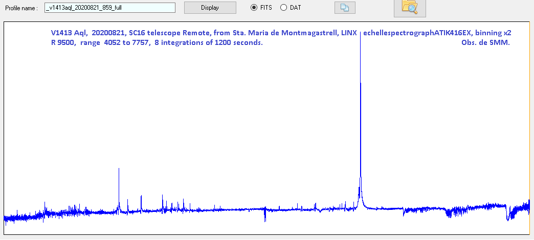

I leave here two graphics to V1413 Aql by LINX echelle spectrograph, night 20200821.
Regards, J. Guarro.
Regards, J. Guarro.
- _V1413AQL1.png (16.84 KiB) Viewed 6687 times
- _V1413AQL2.png (11.71 KiB) Viewed 6687 times
