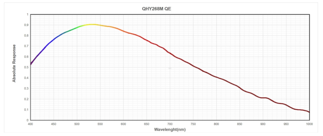

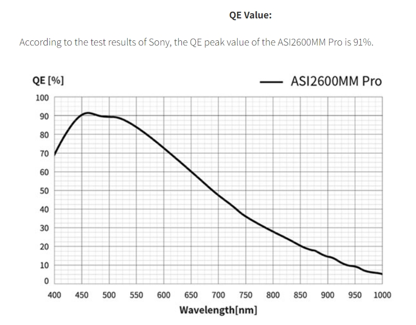

As I am interested in using one of these cameras with my eShel (with Canon 135mm) I was surprised to see that ZWO and QHYCCD have different QE plots for their respective IMX571 cameras. The ASI2600MM QE is better than the QHY268MM, if true.
I have not been able to find a QE plot of the IMX571 from Sony.
What can we believe about the QE?
Bernard
Bernard

- Posts: 731
Re: Sony IMX571 CMOS Monochrome Sensor ?
Hi Bernard,
The QHY268M QE it seems the colour one, but I think , that you could review the report by C.Buil in , http://www.astrosurf.com/buil/asi6200mm/, it 's in French I hope that you don't have any problem wit that, the Google Translator is a good tool.
He explain in it that the some times these QE values don't reflex exactly the reality.
Regards, Joan.

Bernard Heathcote
- Posts: 86
- Joined: Mon Sep 26, 2011 10:09 am
Hi Joan,
Yes, I am aware of Christian's report on eShel optimisation (it has been very helpful) and his comment that the reported QE for the IMX455 is maybe 'optimistic'.
I posted my comment to warn people that there is a discrepancy in the reported QE curves for the ASI2600, so cannot be trusted. We need to wait for Christian to check it for us!
