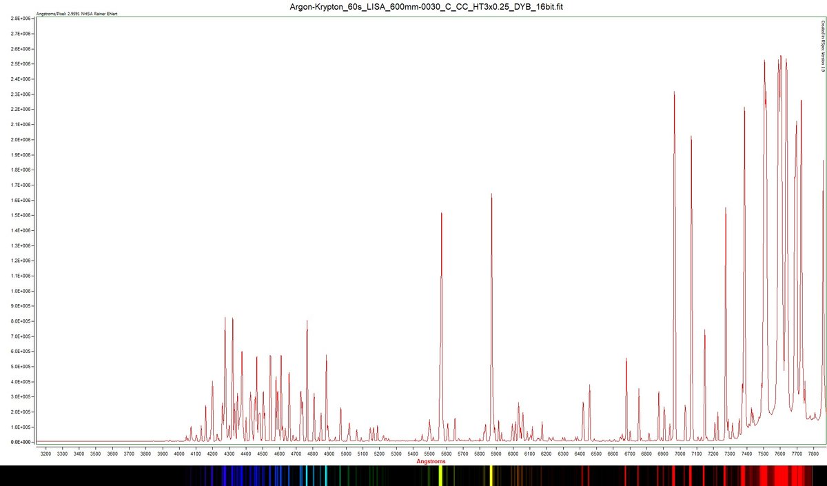

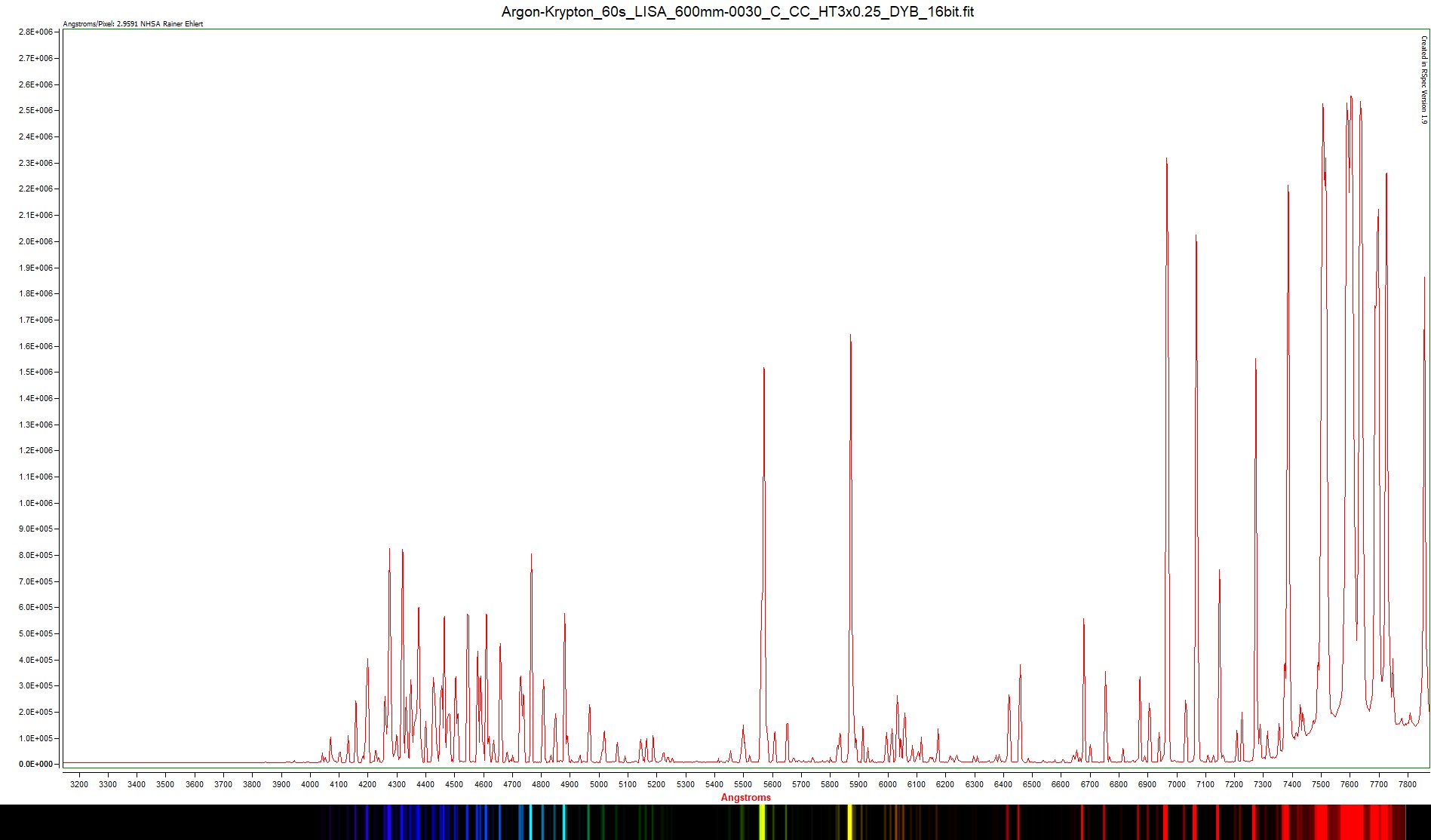

Hi Robin,
Coming back to this topic I have found starter lamps here in Mexico with Argon and Krypton lines and they look like this. In 2012 Richard Walker from Switzerland helped me to define the lines.
