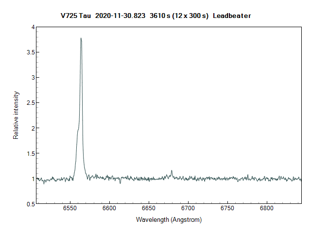

There a only a few low resolution spectra of V725 Tau in BeSS covering many years so it could be a good opportunity to take more during the current outburst. Here is my contribution (H alpha/He 6678 at R~5500 using the LHIRES 1200)

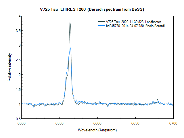

Here is how it compares with the only other medium resolution spectrum in BeSS from 2014 by Paolo Berardi
