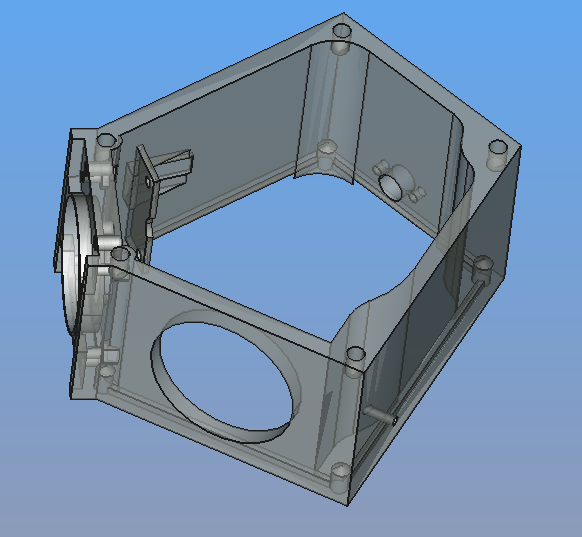

Many of us use the PRUSA MK3I3 printer with satisfaction.
I do not know the mini, which looks so powerful.
Boitier UVEX4.PNG (70.22 KiB) Viewed 4177 times

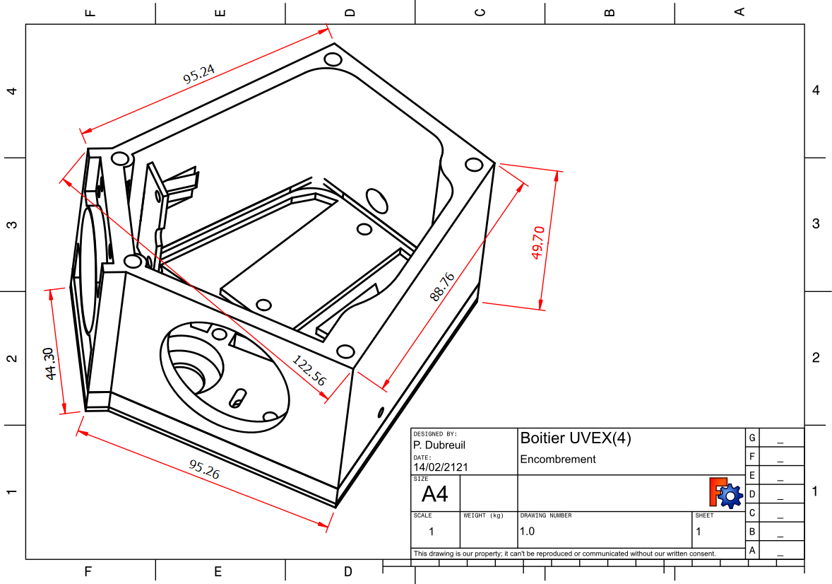

Below some dimensions of the case.
dimensions boitier UVEX4.PNG (159.37 KiB) Viewed 4177 times
Regarding the filament used, we opted for opaque black PETG.
UVEX (4) is operational, STLs available soon.
