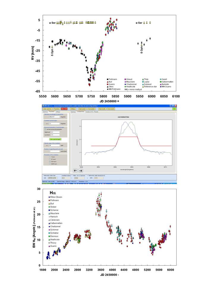

As Anatoly wrote me, the "third body" theory is further an option (first time mentioned of my friend Thom Gandet in September 2011, when we saw the "double dip" in Halpha-RV). This seems obviously to be a outcome of the expert discussion in Brazil.
Before this background, here the newest state of the star in EW and RV (see attachment).
In order to check the reliability of the RV measurements without mirrored technic, I have re-evaluated with the mirrored method within the "RV-cloud" after the periastron some spectra of J. Guarro and B. Heathcote (blue diamonds). It seems, the application of this method leads to some lower values.
