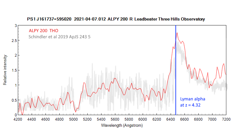

At 19.8 g/17.8 r (SDSS) and a redshift of 4.315, this is the faintest and most distant object I have measured using my modified ALPY200.
My spectrum (red) is shown overlaid on the reference spectrum (grey). The Lyman alpha emission redshifted from 1216A is clear. More details on my BAA page here

Superb spectrum, very impressive. Bravo Robin. With Etienne, you are really pushing the limits.
The lyman forest is also impressive. It seem there is a broad absorber at 5100, and maybe others at various z along the line of sight (large neutral H megaclouds ?). It is like the quasar is acting as a beacon across the Universe, allowing to probe the intergalactic medium !

Yes it is a close race ;-) Etienne's PSS J1458+6813 (with a standard ALPY600 :shock: ) is almost the same redshift.

Can we get any further I wonder ?

Yes the (Lyman damped?) absorption at ~5100 is very strong. Perhaps like the gravitationally lensed APM 08279+5255 here in an early spectrum using the Star Analyser which shows something similar at z=3.07 ?

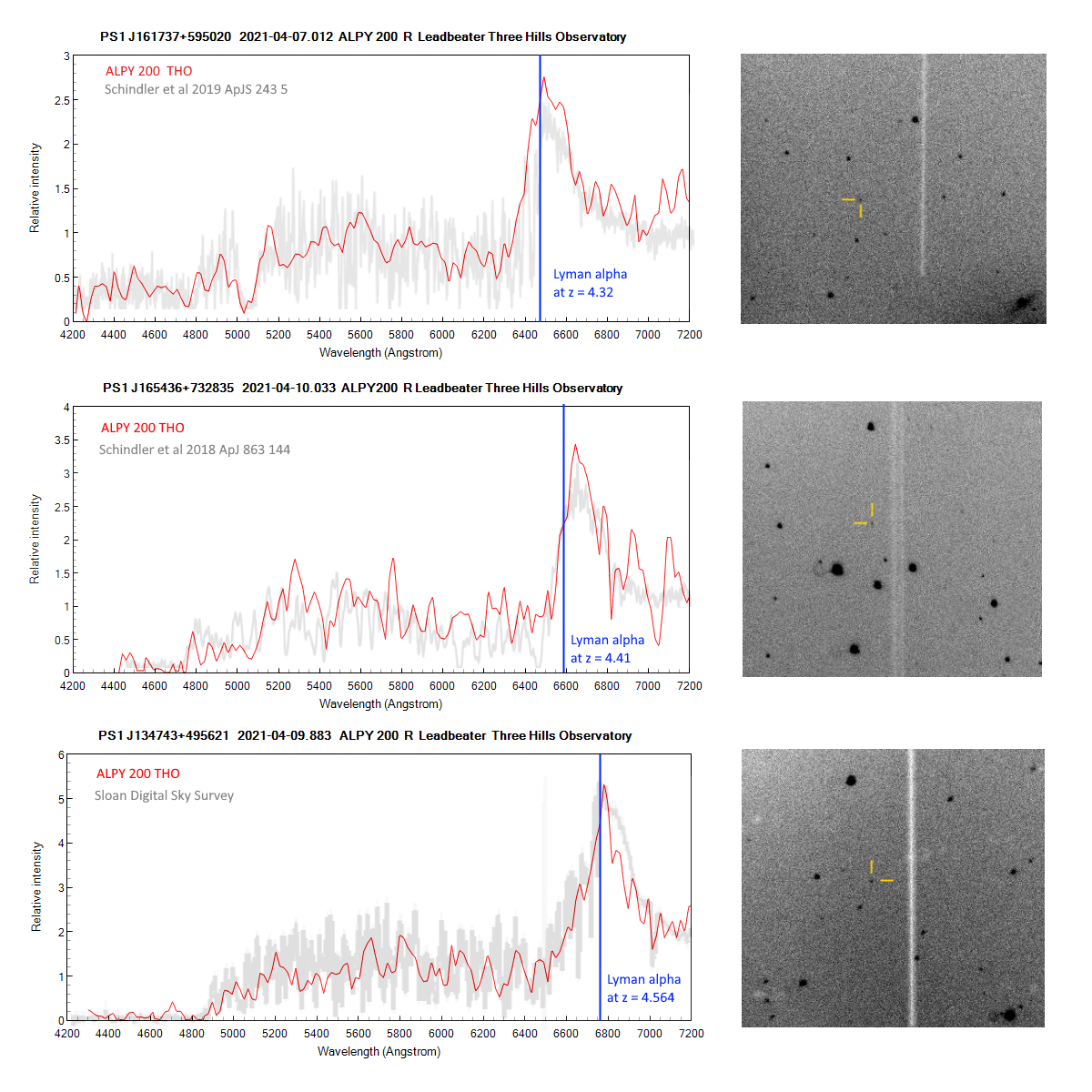

Re: QSO PS1J161737_595020 at z=4.3
A couple more from the PS1-ELQ catalogue at even higher redshifts. The one at z=4.564 is g mag 20.2 r mag 18.4
(the spectra in grey are from the literature. Click on the image to see all three full size)
