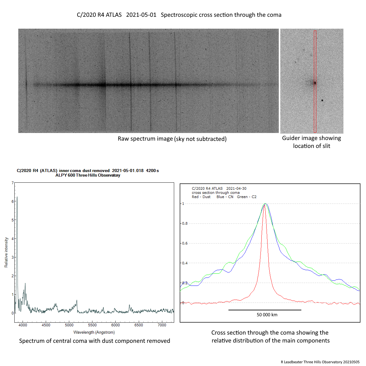

A Star'Ex spectrum of comet C/2020 R4 on a 8-inch Newton reflector, taken the April 24.9, 2021:
The nucleus region spectrum profile (relative to a solar type star):
The coma spectrum:

A spectrum from 2021-05-01 of the emission from the central coma and a cross-section of the distribution of CN,C2 and dust through the coma.
More details on my BAA page
