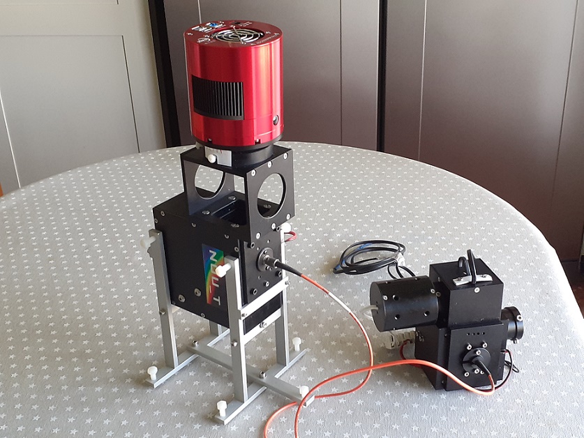

Many thanks for your precise explanations, and because I wrote "all almost". On the other hand, the NOU_T doesn't have a slit, it has a 50 microns diameter air pinhole.
Yesterday when I wrote the first text - you can believe me - I didn't remember that I made some pieces that allow passing the NOU_T from the "direct injection" at the telescope, to an optical fiber system, you can change it in only 30 minutes.
I didn't text that in the NOU_T, but I have experience with the optical fiber on my MUSSOL and LINX echelles and sure this system works well.
You can see it in this picture with an ASI2600MM, but without optics, of course, that model can work with 85 mm. and 135 mm. objectives, the camera cmos size permites it.
But in my humble opinion it is more easy and and practical to observe on "direct injection", so it can take very well the "normal" observations that we make.
BTW, I don't know if for one better light distribution, the fiber patch cables that we use,they would have an achromatic lenses at the same way as the Caos Group show there, http://www.eso.org/~cguirao/caos/presen ... 4.pdf,what is your opinion ?
Cheers, Joan.
