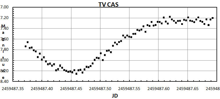

I also obtained many images using the finder to measure TV Cas photometry. Next figure shows the resulting curve, just as predicted for the minimum.
TV Cas photometry.jpg (61.27 KiB) Viewed 5366 times

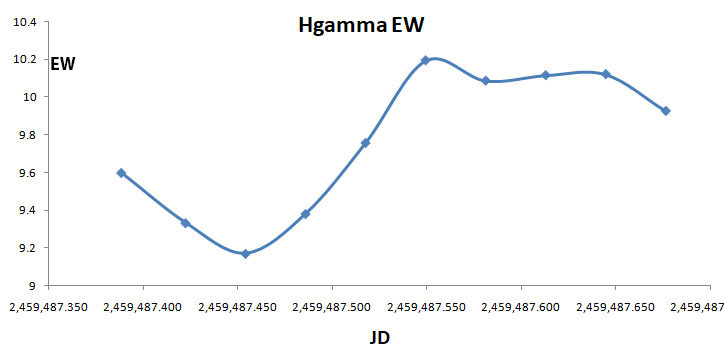

So i measured, using the spectrums without the instrumental response, EW at Hgamma and Mg. To achieve it, i cropped the spectrums to the area around the absotion line, eliminated the continuum and normalized all of them so that the intensity value was one in the flat part out of the absortion line. Then i measured EW in each spectrum carefully trying to use the same limits at the figure. For this analysis i used BASS software.
I obtained this curve for H gamma.
H gamma.jpg (42.23 KiB) Viewed 5366 times
As expected, as the bright star brightness is less and the F star spectrum may show up, Hgamma intensity is minimum coincidental with photometry minimum. Then again, i consider that measuring EW correctly is difficult and my result could be just a coincidence. Maybe the air mass is to blame?

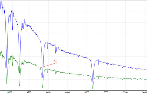

Also, i had a look at the spectrums in which i used the instrumental response. The star used for this response was acquired only once, at the beggining of the session. It was close to TV Cas.
In it it is clearly shown the CH band at 4300 Angstron in the spectrum at minimum brightness and its ausence in the spectrum at maximum brightness.

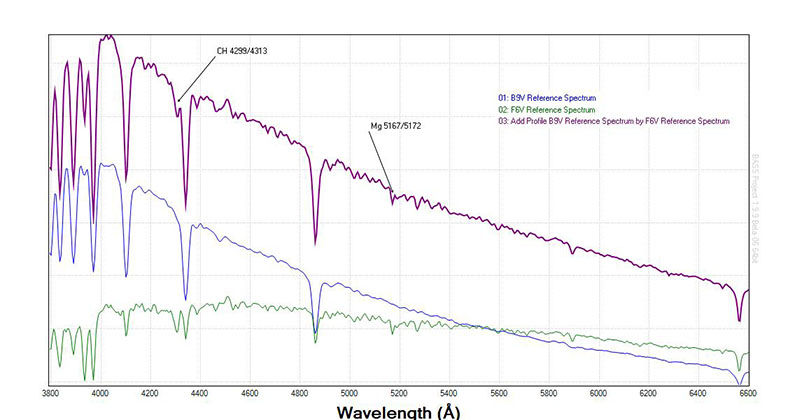

I also added up in BASS the two B and F type synthetic spectrums to check the result, and it seems very similar to what i obtained at minimum brightness.
As a summary, i think i could observe that mimimum in the spectrums. But i am just starting in this spectroscopy world and i am not sure if the procedures i used are correct.

Re: TV Cas
Hi David,
I would say that is a good result. The changes in the features match what would be expected from an increase in the contribution of the F star.
The EW of absorption lines are unaffected by air mass or instrument response as it is measured relative to the local continuum but as a check for best accuracy I try to take at least reference spectra at the start and end of long runs as SCT used with focal reducers suffer from some chromatism which can change the shape of the continuum depending in focus (and atmospheric refraction can have a similar affect if not running at the parallactic angle)
Last edited by Robin Leadbeater on Sat Nov 20, 2021 3:08 pm, edited 1 time in total.
Re: TV Cas
An alternative approach which can show changes more clearly is to produce a template from the outside eclipse spectra and subtract it from the other spectra. (I would expect to see a general increase in the contribution from many other metal lines pop out too). This can also make it easier to measure changes in EW as any unchanged features in spectrum surrounding the line being measured cancel out making it easier to get good reference points in the continuum.
