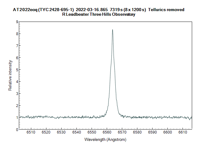

Re: TYC 2428-695-1 a possible new Be Star ?
A high resolution (R~14000) spectrum of the H alpha emission line taken using the LHIRES III shows a "bottle shaped" profile (FWHM 150km/s, EW -25 Angstrom) consistent with a circumstellar disc (J. Silaj et al 2010 ApJS 187 228 https://iopscience.iop.org/article/10.1 ... /187/1/228 )
It seems likely therefore that this is a previously unknown Be star. The spectrum has been uploaded to TNS and the BAA database
