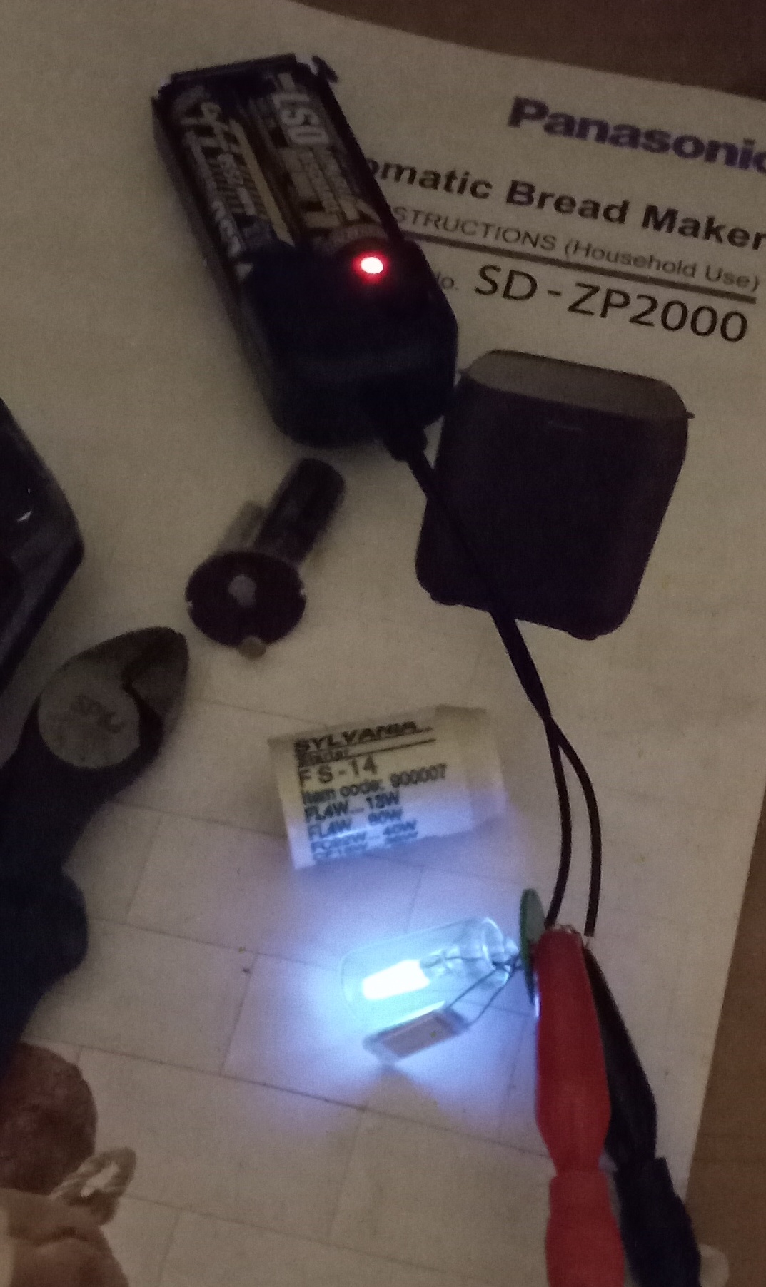

I tried driving my usual fluorescent tube glow-starter (Sylvania FS-14) which has hydrogen and argon lines, so it's very useful, although the h alpha line is rather bright compared to the argon. usually I am driving this with 240v and a series resistor of about 24kohm (more or less, I can't remember). Obviously, i don't like having 240v on the mount outside potentially in wet conditions so I was considering using a 12v-240v inverter as per Christian Buil's recent posts, but stumbled on the EL wire inverters. The series resistor prevents the bimetallic strip switch in the calibration lamp from switching off.
It works fine and no series resistor seems to be required as the current seems to be sufficiently low to not activate the bimetallic strip.
Output voltage of this EL driver is 120V AC when running from 2xAA 1.2V NiMh cells. Rated load on the label of the inverter is 150mA @3v DC. my multimeter measures 14kHz as the frequency but I need to recheck this with an oscilliscope as am not certain about the frequency range of the meter. I was not able to measure the AC current through the glow tube, I guess because my meter isn't able to measure current at such high frequency.
Given that I normally use the calibration lamp for only a few minutes per night, I may not even bother wiring it up to a power supply, in order to avoid the potential injecting 14khz ripple back into other equipment which may not like that sort of disturbance.
So, low cost, intrinsically safe driver for glow starter tubes, and no series resistor required, what's not to like?

but the AA-battery powered micro inverter outputs about 120v at very high frequency, circa 15kHz.
I successfully installed it on the spectrograph and used it a couple of nights ago.

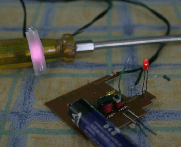

I used the flash circuit from a disposable camera with a 240v RELCO starter
http://www.marcellocucchi.altervista.or ... nlamp.html
Here is my version

I tried various series resistors but ithey seemed to disturb the tuning of the oscillator and the arc wouldn't strike. the lamp was most stable with no series resistor and fresh alkaline cells. Nimh cell voltage was too low to get an arc.
I'm interested to see what the performance of the 12v version is, when it arrives.
