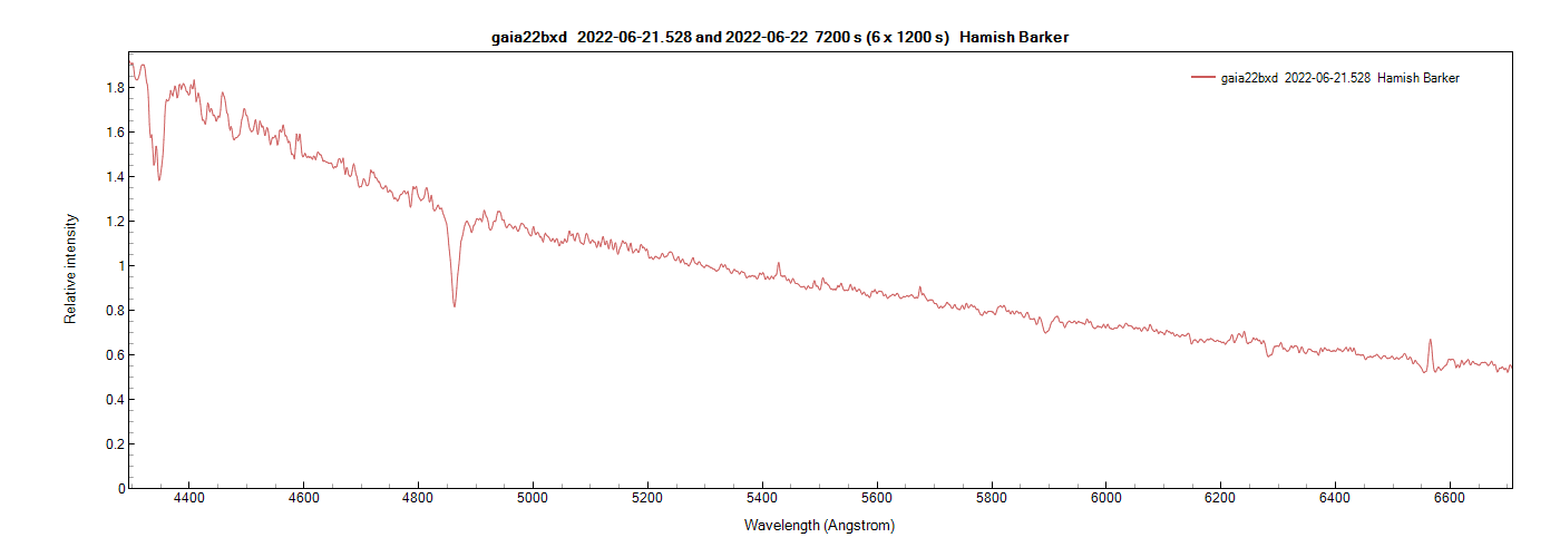

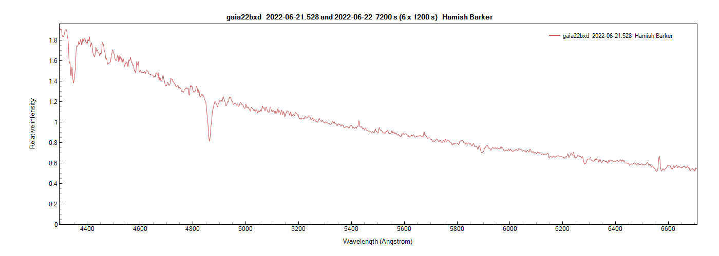

gaia22bxd (http://gsaweb.ast.cam.ac.uk/alerts/alert/Gaia22bxd/ ) also notified as AT2022ksd https://www.wis-tns.org/object/2022ksd
has brightened by about 0.3 magnitudes in the last 6 months, to about magnitude 9.7.
I have taken several spectra, here is an addition of 2 consecutive days. Looks like a B or A type star with a little H alpha emission and maybe there is also some emission in the middle of the Hgamma absorbtion line.
Any suggestions on where to take this or likely classification?
gaia22bxd possible new Be Star?

It is HD124791 with a classification of B8II.
https://simbad.u-strasbg.fr/simbad/sim- ... D%20124791
If correct it is a giant so not a classical Be, though the classification (from a reference in 1975) could be wrong of course.

Follow up at high resolution could be the next step, following the procedure used for the past Be survey

Thanks robin, I was going to email you directly. Can send the fits files if interested. I have a couple of additional observations as I was not happy with whether the spectra roughness is intrinsic, or just low s/n.

Since it is not a previously known emission line star it is probably worth at least classifying it as "other" on TNS with zero redshift ? With a description of the spectrum along the lines of
"spectrum shows a blue continuum with Balmer lines in absorption and H alpha with a central emission component. The redshift is close to zero indicating a galactic source, possibly a Be star"

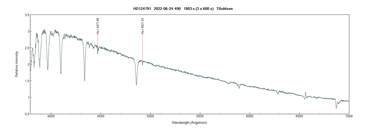

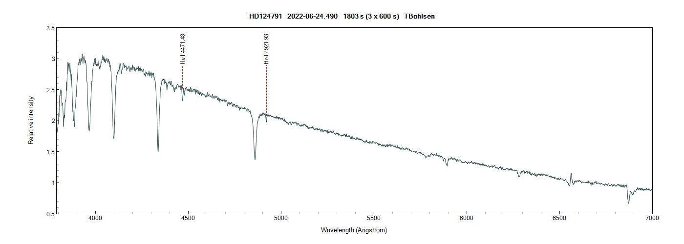

I have also taken a spectra of this star. It is also known as HD124791 and is catalogued as a B8II C on SIMBAD. It certainly seems to be a B star and it has some weak He lines. I can only identify H emission at Ha.
